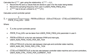

Dear team:
The customer uses the formula in the following document to calculate the pI value:
Files\MotorWare\motorware_1_01_00_18\sw\solutions\instaspin_foc\boards\drv8312kit_revD\f28x\f2806xF\src
The PI value of the calculated current loop (PWM frequency is 15KHz) is: Ki = 0.03098,Kp = 0.0926
If the PWM frequency used is 20kHz displayed on the GUI interface, the calculation result is: Ki = 0.02324,Kp = 0.2696
The customer uses GUI to control the motor. After inputting the same parameters on the interface, the identified parameters are inconsistent every time.
1, Excuse me, which document should be used to calculate the pI value?
2, How are the parameters in the GUI determined, such as res EST current, Ind EST current, estimation freq, etc?
