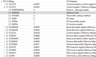

    Also I noticed something strange. This is likely my poor understanding of how the C2000 interrupt scheme works with nesting involved. I noticed when I enter the interrupt PieCtrlRegs.PIEIFR9.bit.INTx3 is set to 0 (shouldn't it be 1?), and when I set RXFFINTCLR to clear the RXFF interrupt status, immediately after this PieCtrlRegs.PIEIFR9.bit.INTx3 gets set to 1, which indicates to me that something is causing the interrupt to go pending again? Maybe this is why I'm stuck forever in the interrupt because it's always pending? I'm quite confused. Maybe it's just a coincidence that it occurs when I clear the RXFF interrupt status, but it's certainly not helping that the interrupt is pending again when the RXFF status is cleared. Maybe this is what is expected to happen because the line is held low and as soon as I clear the RXFF status the interrupt goes pending again? I could use further clarification on why the SCI receive interrupt goes pending again.
    Here's the really strange thing. When I insert a delay between clearing the overflow status bit and clearing the RXFF status, and then I perform a processor reset setting a breakpoint in the ISR, I hit the breakpoint 7 times (seven SCI B RX interrupts), but then I never receive an interrupt again (PieCtrlRegs.PIEIFR9.bit.INTx3 remains 0) and the code performs as normal. Did this somehow break the SCI B peripheral?
        ScibRegs.SCIFFRX.bit.RXFFOVRCLR = 1; // Driverlib: SCI_clearOverflowStatus(SCIB_BASE);
        // DELAY(100us);
        ScibRegs.SCIFFRX.bit.RXFFINTCLR = 1; // Driverlib: SCI_clearInterruptStatus(SCIB_BASE, SCI_INT_RXFF);
    Here's a screenshot of ScibRegs after the seven interrupts:

    I assume you meant to paste from the SCI peripheral section for SCICTL1 Register bit SWRESET? In which case either way it looks like the SCI configurations are untouched by a peripheral reset.
    My apologies, yes, I meant SWREST bit of the SCICTL1 register. Correct, none of the actual configuration should change after performing a software reset.
    Marlyn
  • Thanks Marlyn, this ended up being the solution to recover from a SCI break condition. We ended up checking SCIRXST BRKDT == 1 to detect a break condition and turn off the interrupt. Then we have a task running in the background that monitors for the break condition to clear and re-enable the SCI interrupt, more specifically, if SCI break condition has been detected && SCI RX GPIO is IDLE HIGH 1 state then reset the SCI peripheral and re-enable the SCI rx interrupt.
