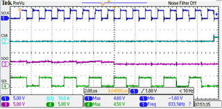

Hello everyone,
I am working with the SPI module on the F28379D board. On my master end, I currently have my character length set to 16 bits. However, I wish to change this to 8 bits. When I attempt to do this by setting the SPI character control bits to 8 as follows: SpiaRegs.SPICCR.bit.SPICHAR = 0x7, I stop getting any data written altogether on my MOSI line.
I've tested this by transmitting 0xAA and 0xAAAA, when the SPICHAR bits are set to 8 and 16 bits respectively. When they are set to 16 bits, I get the correct transmission show up on my oscilloscope. However, when they are set to 8 bits, I get nothing on my SDI line.
I wanted to figure out why this is happening and how I can fix it.
Below are my oscilloscope plots:
Scope when SPICHAR = 16 bits (data transmitted on SDI 0xAAAA)
Scope when SPICHAR = 8 bits (data transmitted on SDI 0xAA)
Below is my code listing

SpiaRegs.SPITXBUF = 0xAAAA;
 Below is my setup for the SPI registers (also note, I am not using FIFO enhancements):
