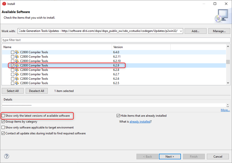

    I checked for available compiler updates and saw 6.2.9:
    I selected it and had CCS download and install it.

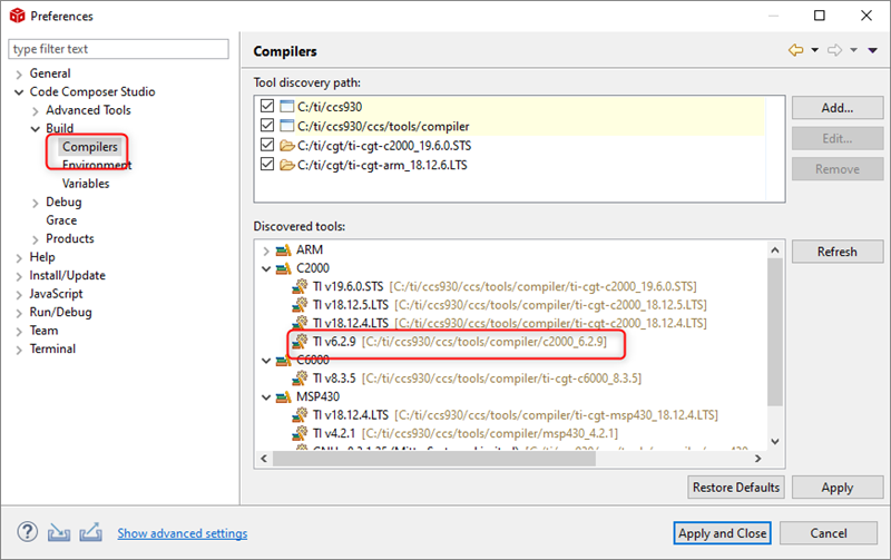

    After CCS restarted, I can see that CCS has discovered compiler 6.2.9:

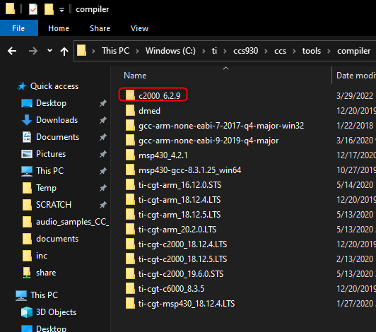

    If you do NOT see it here, try pressing the "Refresh" button to have CCS scan for it. If it does not find it, please browse to the below location:
    <CCS INSTALL DIR>\ccs\tools\compiler
    It should appear there if the compiler was actually downloaded and installed on your system.
