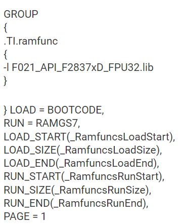

I have a warning due to the  F021_API_F2837xD_FPU32 libraries added to my project.
I am using this library because my code could not be run from flash. the code was running but now with some code modification in another module, my code is staking 0x3fe494 in BROM.
I am trying to integrate this library into my project because I read in a previous post from TI this:
when I added the F021_API_F2837xD_FPU32  to the project I added also this to the cmd file,
GROUP
.TI.ramfunc
-l F021_API_F2837xD_FPU32.lib
} LOAD = BOOTCODE,
RUN = RAMGS7,
LOAD_START(_RamfuncsLoadStart),
LOAD_SIZE(_RamfuncsLoadSize),
LOAD_END(_RamfuncsLoadEnd),
RUN_START(_RamfuncsRunStart),
RUN_SIZE(_RamfuncsRunSize),
RUN_END(_RamfuncsRunEnd),
PAGE = 1
my problem now is I have a warning issue, in the map file I could not see the librarie liked to the project.
The warning says:
Description Resource Path Location Type
#10068-D no matching section saver.cmd
Thank you in advance,

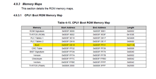

  • Hi Tarik,
    0x3FE494 is the BootROM ITRAP ISR address as per the TRM (section 4.9.2 Wait Points in https://www.ti.com/lit/ug/spruhm8h/spruhm8h.pdf).
    As shown in the flash API example in C2000ware, please ensure that the application calls memcpy() to copy the flash API (and the functions that call flash API) from flash to RAM.

  • In the project I am working i have this in the cmd file:
    BOOT_RESERVED       : origin = 0x01BFFE, length = 0x000002
    StartUpSect         : > BOOT_RESERVED,         PAGE = 1
    I am not sure of this because in the user manual we have this:
    I didn't call any function from that API, should I have it in my project even if there is no call? Does any implicit call to the API exist by the hardware?
  • Hi Tarik,
    Since your application got in to an ITRAP, I was asking what is the "BOOTCODE" memory entry definition in your linker cmd file.  See below snapshot that you shared where you have BOOTCODE for load.
    If your application is not using the flash API library (F021_API_F2837xD_FPU32.lib), you don't need to include that library in your project.  There is no any hidden call to that library unless your application uses it.
    Thanks and regards,
    Vamsi
  • Hello Vamsi,
    Actually, my application is another bootloader.
    here is the BOOTCODE mapping
    BOOTCODE            : origin = 0x08001C, length = 0x003FE4
