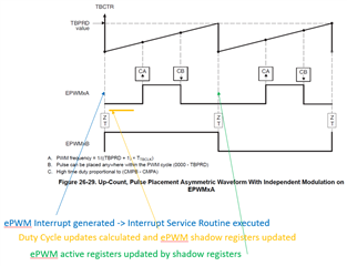

Our gate signals are setting at 0.1 and resetting at 0.6. In a certain condition, we transition to setting at 0.7 and resetting 0.2. The gate is initialized with zero therefore in the transition period we will have a long zero gate signal (from 0.6 of the first pulse to the 0.7 of the second pulse). It will be great if we could initialize the ePWM to start from 1 at "counter equals to zero" in this situation.

  • Yes by setting at 0.1 I mean 0.1 of TBPRD. Sorry for not explaining it well. The issue with using CMPA in rising edge and using CMPB is that sometimes we are setting at the rising edge and sometimes we are setting at the falling edge. But it seems like you cannot change that after you set the registers. I have attached a picture of the situation.
  • By the way, we are using up count (sawtooth) but if there is a solution that uses up-down we can switch to that.

  • After the third section, it gets back to normal. Here is the picture:
    First thing, I believe this transition is supposed to happen based on a particular event so that we can track the event and enter an ISR in which the PWM data can be updated.
    Now when you enter the ISR, multiple things can be done: (This is considering that you're using the up-count mode as mentioned earlier)
    1. Update the CMPA and CMPB values to what you've marked in the image when the TBCTR = TBPRD. This will ensure that before the start of new cycle, i.e. Section 3 in your case, the counter values are ready to generate the required PWM.
    2. The conditions of CTR = CMPA/B and CTR=ZRO can be utilized to generate the PWM. Configure the PWM to set when CTR = ZRO; reset when CTR=CMPB (0.2) and set it again when CTR = CMPA (0.7).
    The next condition CTR = ZRO would become a don't care since anyways the PWM is high because of CTR = CMPA (0.7).
    You can do something similar using the up-down count mode as well. I believe that can be little easier to configure since the flexibility in updating the CMPA and CMPB registers is high (both CTR = ZRO and PRD are different events)
    You can work on this as well to see whether it fits your requirement.
    Hope this helps.
    Aditya
  • Thanks for your reply.
    These all are incorporated but it does not work because if we " Configure the PWM to set when CTR = ZRO" as you mentioned our PWM signals will be wrong for the first two PWM cycles shown in the picture. The issue is that you cannot configure the PWM to change between "set or reset" when ctr=zero after you are done with configuring and the program is running.

  • You can use immediate load in place of shadow load to resolve this issue.
  • Marzieh,
    From our offline conversation, we discussed the following as a method to implement the phase shift by manipulating the duty cycle and position of the edges with the CMPA and CMPB.  The attached example C code illustrates an example.  Your specific implementation would likely vary from this.
    Also, the following diagrams try to illustrate the behavior of the C code.
