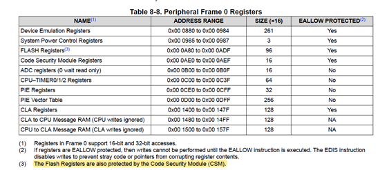

    Thank you for your reply! Now customer still want to confirm the following questions:
    1. In the datasheet of F28035, it is mentioned that the flash register and CLA register are protected, as shown in the figure below. However, the same description was not found in the "Peripheral Registers Memory Map" of the F280049 datasheet, so please help to confirm which registers of the 280049 are protected by DCSM?

  • EALLOW protection is completely different from DCSM protection. DCSM protects unauthorized copying of the flash contents, which is protected by a password. EALLOW protects registers/bits from being modified by rogue code or unintentionally. There is no passwords involved with EALLOW. These are two completely different mechanisms. Also note that the flash technology used in F280049 is very different from F8035. Hence flash control registers are also different.
