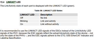

I am writing to ask the effective power level of LINKACT pin in F28388. Is it high effective or low effective?
Could you kindly share the links of material that have this information? Not able to find such information in F28388 DS or ET1100 DS.

    I think it's active low based on the Beckhoff datasheet (here) and the ControlCard schematic design, i.e. No Link = HIGH state where LED is OFF. I will double confirm however and review how this can be better documented.

    The Green Light (GPIO143) behavior seems to match the LINKACT behavior from the Beckhoff datasheet, except I would have expected it to blink when there's both Link and Activity existing. Not certain why this differs right now.
    The Yellow Light (GPIO148) acts as an input from the C2000 perspective. I don't believe Beckhoff defines requirements for this LED. We connect it to LED_0 output from the PHY on the ControlCard design, below is from DP83822 datasheet. Seems like Mode 2 may be configured.
    One thing I noticed in our C2000WARE EtherCAT examples is that we configure GPIO143 and GPIO144 as invert polarity. I suppose this is done to match the LED circuit (active low).

    I have tested this on my side with F2838x ControlCard and C2000WARE software. I witness the below behavior:
    Link State
    GPIO143 Green (LINKACT) LED – F2838x OUTPUT
    GPIO148 Yellow (PHY LINKSTATUS) LED – F2838x INPUT
    No Link
    ON
    Off
    Link WITHOUT activity
    OFF
    ON
    Link WITH activity
    Blinking
    ON
    In conclusion, the polarity of GPIO143 Green (LINKACT) LED is actually incorrect on the ControlCard.
