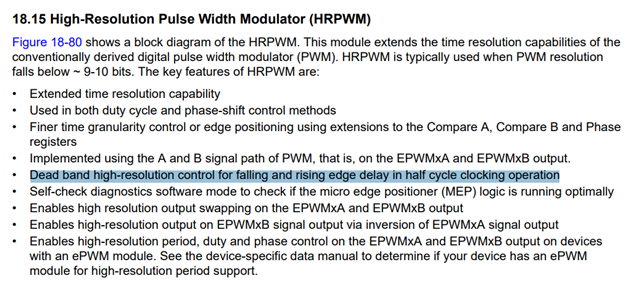

My customer is developing the HRPWM code, and they confused that the below sentence, What exactly does it mean?
And It means that we can only Up-Down mode can generate the HRPWM? Thanks!

"Dead band high-resolution control for falling and rising edge delay in half cycle clocking operation" means that the dead band delays (rising and falling edge) for high resolution module are available only in half cycle clocking. Half cycle clocking is basically an add-on feature for the dead-band submodule where the dead band counters count at a rate of TBCLK*2 instead of TBCLK for enhanced resolution.
No, not really. You can use the HRPWM module in up-count and up-down count modes. Only the down-count is not supported.
