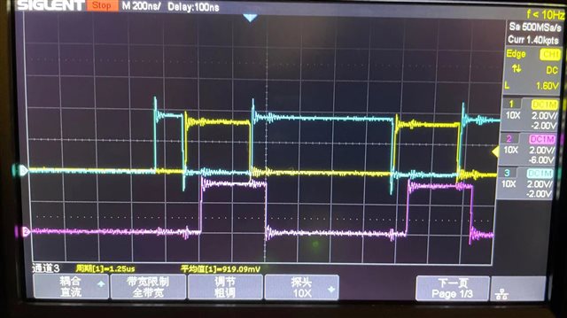

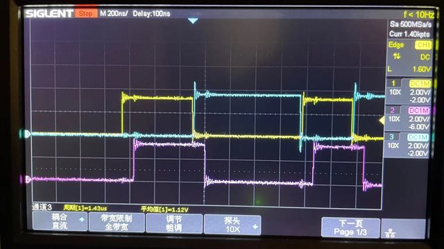

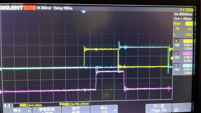

    The test results are shown below. The star-up pulse sequence, i.e. the first PWM cycle seems random, which is undesirable. We need the first PWM cycle is deterministic and should have the same duty and phase shift as the next ones.
    CH1: EPWM1A, CH2: EPWM2A, CH3: EPWM1B
    1st try
    Star-up pulse pattern 1
    2nd try
    Star-up pulse pattern 2
    3rd try
    Star-up pulse pattern 3
  • Can you please share the initialization code for the PWM?
    The waveforms that you've shared are after the trip has been cleared?
  • The waveforms are captured when re-start by setting CmdRun = 1. Before that, both EPWM1 and 2  have been one-shot triped by clear GPIO34 to low as TZ1 and the converter is in a stop state (StateRun = 0). The first PWM cycle pulse pattern may differ each time re-start, as shown in the above-mentioned 3 waveforms.
    Looks pretty much correct unless I am missing something. Can you please additionally try one more thing?
    Just before enabling the clock in the cmdRun = 1 function, can we reset the counters to zero? This should surely ensure that the counter starts from zero when we turn on the PWM.
    This also can be validated by putting a breakpoint at the OST clear line and checking the value in the TBCTR register to see if there's any preset value in that.

  • The last state will be changed as long as the TBCLK is still running. Other AQ actions (CTR=ZERO, etc.) will happen to change the PWM output states. How can we ensure that SW forced action is the last one? Here is the dilemma.
  • Well the SW forced action will be right before the TRIP condition is removed. If another action (TBCTR=ZERO or others) come in, they will change the state, but they should change both states of A and B output together. I dont fully understand the issue. If you dont want other actions to interfere you can disable all other actions before sending he SW FORCE action.
    Nima
  • When CmdRun=0, the AQ actions of EPWM1 and 2 are intentionally and temporarily set to clear low after tripped. And let the TBCLK free running. With that, the last state of EPWM1A and EPWM2A will be low and EPWM2B and EPWM2B will be high, which is desired by application. When CmdRun=1, disable TBCLK first, reset the TBCTR=0, then recover the AQ actions setting to normal mode. Then, clear the OST bit. Here the initial pulse pattern will be ouput as desired, i.e. EPWM1/2A low while EPWM1/2B high. Finally enable the TBCLK. This resolved my issue. Thank you very much!
