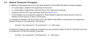

  • Furthermore, if you could just clarify regarding why the data length for transfers is set to 32-bits, despite only ever transmitting 16-bit words in the DMA. Would it not be faster/more efficient to set this to 16-bit transfers, since the leftmost 16-bits won't actually contain any information that is useful.
    Finally, could you help me with the setting of the shadow registers for changing the address to be sent to the DMA. I cannot find this information in the DMA API guide DMA Module — F2837xd API Guide (ti.com)
    At the moment my two DMA channels are just sampling the same buffer because I am not changing the address during the DMA ISRs. I assume I will need two DMA ISR's:
    DMA1 triggered by the ADCD INT, set DMA INT once array filled, and set shadow address (not sure how to do that, yet)
    Then, we should have a second DMA INT, for the second array. I assumed that this would be triggered by an INT on whichever ADC it is converting, for example ADCB. However, do we not need to wait for DMA1 to finish first according to the above pseudocode - but I do not see anywhere that DMA2 could be triggered by the end of DMA1.
    My question therefore, alongside the channel transfer length one, is how do we set up the interrupts to ensure that only one buffer is being filled while the other is being processed while ensuring no overwriting - it seems that you cannot do this in parallel and some level of waiting will be involved which will also reduce the effective achievable sampling rate of the ADC's, or alternatively how large the array that holds the values can be. Is it true that you cannot fill DMA channel 1 and DMA channel 2 simultaneously? If so, there must be some code in DMA INT2 that checks whether the first DMA has finished first?
    Maybe the following is in important note, from the TRM: "If implementing a ping-pong buffer scheme with continuous mode of operation, then the interrupt would be generated at the beginning, just after the working registers are copied to the shadow set. If the DMA does not operate in continuous mode, then the interrupt is typically generated at the end when the transfer is complete." I currently have it set up to INT at end of the DMA transfer, so might be one reason why it is not working as expected.

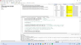

    No problem, I understand there is a lot to reply to. Just as an update, I changed the code so that ADCDbuff is now filled with differential values, and ADCBbuff is filled with single-ended values. This was done by fixing that part of the code where, for some reason, the TI code was filling the second DMA channel, with ADCD as the destination, with data from ADCB source rather than ADCD:
    DMA_configAddresses(DMA_CH2_BASE, (uint16_t *)&adcDDataBuffer,
    (uint16_t *)ADCBRESULT_BASE);
    Here is the new screenshot:
    However I am still not sure this is fully correct, as I have not set any shadow addresses within the two DMA ISR's that I have setup. So this code, as it stands, just fills DMA channel 2 with data from a 12-bit ADC channel continuously, and DMA channel 1 fills with data from a 16-bit ADC channel continuously. It seems to work OK but I would like to get the benefits of setting up a ping-pong between them such that I can more effectively actually process this data.
    Take your time.

    My question is, how fast can a DMA actually transfer data? The data sheet says 4 cycles/word, so it would take 128 clock cycles to fill a 32 element array of 16-bit integers, which is around 640nS.
    At 20nS per word, this is less than the acquisiton period for a 12-bit and certainly a 16-bit integer value, so the limiting factor for the speed of filling the array will be the AQCPS and it is likely the array might be filled with duplicate values if the acquisition period exceeds 20ns.
    It really does not make sense, then, that for a worst-case 1us time taken to fill a 32 element array of 16-bit integer values, that the DMA code and any averaging done would take 999uS or longer, assuming the counter is incremented if the timer ISR has a time greater than 1mS.
    When you get time tomorrow please do try and clear up these issues regarding the throughput of the DMA and give any ideas for why the ISR may be taking so long. If 1ms is a standard time for a DMA transfer ISR, then that is OK, but I will need to find an alternative way to sample and process my data because that's not good enough for a 1MHz AC signal!
    Enjoy the rest of your weekend,
    Joel
  • Joel,
    Thanks for the additional detail.  Based on my interpretation of the TRM the datarate of the DMA should be slightly faster than you mention at 3 cycles/word given from the TRM below.
    If I assume worst case 16-bit transfers this should be:
    32 16-bit words, in 4 bursts of 8 words each time:
    4 bursts*(3cycles/word)*8 words/burst)+1) = 100 cycles @ 5ns = 500ns for 32 ADC results.
    If we picked 32-bit word length, we could knock this down to ~250ns.
    All this to say I agree that 1ms time is not what I would expect either, even with the overhead of flushing the pipeline/etc.

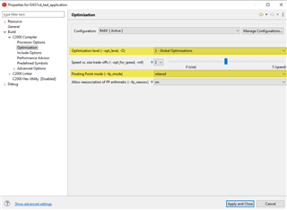

    A few things to consider:
    1)Code location for the ISR, is it in flash vs RAM.  Keep in mind that flash will be running at 3WS at 200MHz ~50MHz, basically 4 cycles to fetch instructions in flash vs 1 cycle in RAM
    2)If you are using the same RAM for both sets of the ping/pong buffer, then we could get contention and this would add a cycle of delay for each side(the DMA and the CPU depending on which made the request).  That might be moot if the time between samples is bigger than 500ns, but I don't think this is true.  This may be where you are getting the 4 cycles a word from above, but as you have shown this is still only 640ns, which assumes we stall on every word.
    3)If your code is is in the same RAM block as the DMA buffer, but I doubt this is the case.

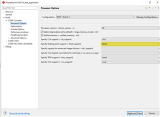

    4)Optimization: both code generation as well as using the floating point accelerator:
    Right click on the project and select "properties" at the bottom of the drop down.
    Then make sure the processor options as well as optimization are configured as shown below, with both FPU32 selected, as well as opt level 2 and floating point mode set to relaxed.  This should give the best performance
    If you are still seeing very slow ISR performance, we may need to profile the code to see exactly what is going on.
