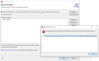

I installed Code Composer Studio Version: 11.2.0.00007 and when I want to import the launchxl demo project from examples folder, I got and error saying that meta-data cannot be interpreted. Like in the attached picture.
.Import error
Any other project from examples folder can be imported without problem.
What I noticed by looking inside the examples projects, is that launchxl project is missing .ccsproject and .cproject files. The other projects have these files, but launchxl is missing.
I tried to create them manually, by copying content from led project example and I can import launchxl project. But I run into compiling and linking errors where I get stucked.

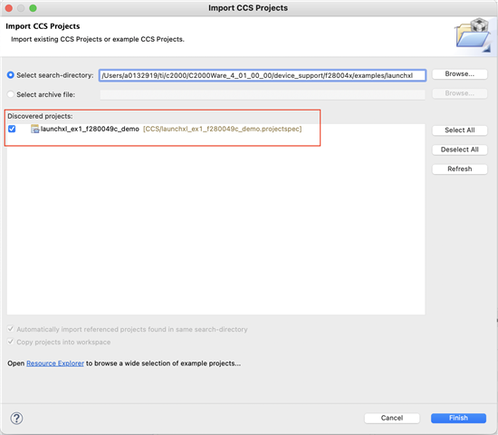

  • Liviu,
    Something looks different on your import. When you import, the screen should like this
    Can you send the projectspec file from that folder?
  • Here is an archive containing the launchxl folder. I don't really know which is the projectspec file.launchxl.zip
    You have .ccsproject, .cproject, and .project and also .project in CCS folder.
    Please delete those files and then import the project. It should work fine.
    I have deleted the files in the attached zip file.
    3603.launchxl.zip
    Thanks & Regards,
    Santosh
    Just deleting the files you mentioned did not changed anything, the same error.
    BUT with the folder you gave me, it worked! Then I compared the content between your folder and the one from my installation and the only difference was the presence of *.DS_Store files in your folder. With those files everything is fine, without them I get the error. It's interesting that other examples also don't contain *.DS_Store file, but I can import.
