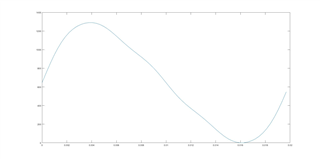

I am trying to use RFFT for analog data on F28379D-LAUNCHXL. Before that I have constructed the below signal in  MATLAB at the frequency of 3.2 ksps
than converted the decimal values to the Q31 format using some scaling factor M > Max of signal (let 1300 > 1290) and 2^31, such as final scaling factor as 2^31/1300 = 16,51,910.

Also, when I am trying to get back the magnitude in the decimal format below is the output for different frequency components -
Q31 Decimal(output of FFT) Decimal(Actual) Input
Dc 264680099 160.2267067 645.430303
Fundamental ( 50Hz) 61190090 37.04202408 620.6060606
100Hz 2450431 1.483392558 124.1212121
150Hz 152972 0.092603108 31.03030303
200Hz 0 0 0
250Hz 24725 0.014967522 12.41212121
decimal output is derived from Q31 output by dividing with initial factor (1651910) used to convert the decimal value to Q31 format.
Can you help me understand why output decimal values are not same as the input decimal inputs.,
