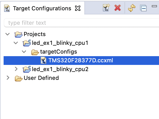

  • Ray,
    Let's follow following steps:
    • Open the target configuration view  : CCS menu View -> Target Configuration
    • Expand the project folder, and right click the target configuration, and launch it
    • connect CPU1 and CPU2
    Are they able to connect both cores?
