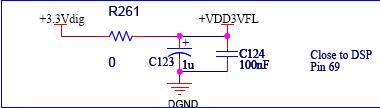

    I have requested of the electronics team to investigate the power circuit for the flash (attached graphic).
    I proposed that something (solder bridge, failed capacitor film, or something) may have caused some of the VDD's 3 volts to be dropped across the series resistor, causing the voltage seen by the flash module to be too low.
    The only fly in that ointment is that at least one of the 3 failed units was re-programmed successfully. That points to this being at most an intermittent problem.
    It seems a stretch to me that an intermittent cause would remain solidly in place up until a reprogramming attempt was tried (and succeeded)

    I am curious as to why you have that series resistor in the VDD3VFL rail. Although the graphic shows its value to be 0 ohms, its presence could potentially cause issues (such as bad solder, incorrect resistor value etc) . Have you verified the value of VDD3VFL to be 3.3v?
    Yes, we have done this. The connection is a soldered wire. We have measured its resistance, which is very near zero, and the voltage to the VDD3VFL pin is 3.3V to a very tight tolerance.
