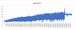

  • Hi Luo,
    1. In user.h we set the USER_MAX_ACCEL_Hzps to 0.5 and USER_FORCE_ANGLE_FREQ_Hz  to 1.
    2. in labs.h we set accelerationMax_Hzps to 1.
    3.We tested the PMSM motor (Estun_EMJ_04APB22_A) and we captured the feed back speed from serial port( I have attached image in below)
    4. We give the reference speed(Hz) = 50Hz.
    5.In the above we observed that there is oscillations in the feedback speed.
  • Do you capture any current waveform?
    How do you judge an oscillation in the feedback speed?
    Do you try to identify the motor parameters and tune the gains of the speed PI controller? And check if there is any changes when tune the gains?

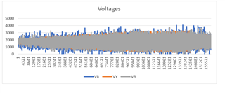

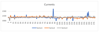

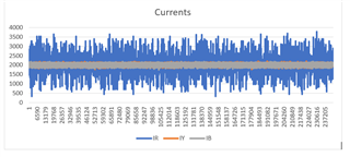

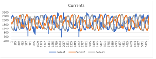

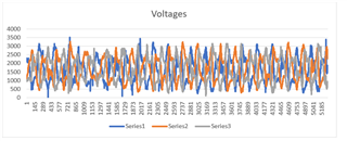

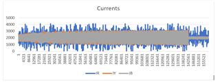

  • Hi Luo,
    Thanks for the reply,
    1.We tested our motor in no load and load, I have attached the ADC_Data plots of both cases
    2.Below are my code settings in both load and no-load conditions.
    2a. user.h settings.
    #define USER_MAX_ACCEL_Hzps        ((float32_t)(1.0))
    #define USER_FORCE_ANGLE_FREQ_Hz            ((float32_t)(1.0))
    2b.Motor parameters
    #if (USER_MOTOR == Estun_EMJ_04APB22_A)
    #define USER_MOTOR_TYPE                    MOTOR_TYPE_PM
    #define USER_MOTOR_NUM_POLE_PAIRS         (20)
    #define USER_MOTOR_Rr_Ohm                 (0.0)
    #define USER_MOTOR_Rs_Ohm                 (2.35093718)
    #define USER_MOTOR_Ls_d_H                 (0.033496008015)
    #define USER_MOTOR_Ls_q_H                 (0.033496008015)
    #define USER_MOTOR_RATED_FLUX_VpHz        (5.5)
    #define USER_MOTOR_MAGNETIZING_CURRENT_A  (NULL)
    #define USER_MOTOR_RES_EST_CURRENT_A      (1.0)
    #define USER_MOTOR_IND_EST_CURRENT_A      (-1.0)
    #define USER_MOTOR_MAX_CURRENT_A          (7.4)
    #define USER_MOTOR_FLUX_EXC_FREQ_Hz       (20.0)
    #define USER_MOTOR_NUM_ENC_SLOTS          (2500.0)
    #define USER_MOTOR_INERTIA_Kgm2           (3.10002e-02)
    #define USER_MOTOR_FREQ_MIN_HZ             (10.0)           // Hz
    #define USER_MOTOR_FREQ_MAX_HZ            (48.0)         // Hz  120%of rated //increased to 48 from 30
    #define USER_MOTOR_FREQ_LOW_HZ            (4.0)          // Hz   //increased to 4 from 2.5
    #define USER_MOTOR_FREQ_HIGH_HZ           (40.0)         // Hz   //increased to 40 ffrom 25
    #define USER_MOTOR_VOLT_MIN_V             (35.0)          // Volt
    #define USER_MOTOR_VOLT_MAX_V             (260.0)         // Volt
    2c. Labs.h settings
    accelerationMax_Hzps   (0.5)
    A. ADC data of speed, current and voltage plots: (No load)
    Zoom in voltages and currents: (No load)
    B. ADC data of speed, current and voltage plots: (Load)
    Zoom in voltages and currents: (Load)
    3. In load condition motor ran with vibrations and did some noise
  • Any voltage and current waveforms captured by an oscilloscope with current probe? And do you try to tune the speed controller?
    I don't think there is any issue from the InstaSPIN-FOC algorithm, you may try to tune the current and speed controller, and the acceleration according to the system.
    BTW, try to identify the motor parameters without any load. Make sure that the motor run smoothly without vibration by tuning the identification variables.
