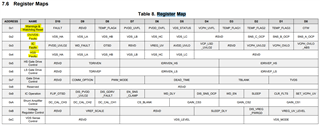

Hello, I am working on BLDC sensored motor with lunchpadTMS320F29379D + DRV8305. my question is:
1.  nfault pin always ON ,it is ok ?
2. for SPI interface what configuration is required? I removed J1P,JP2 and JP3 . but not able to get output.
I take reference code for DRV8305 from INSTAPIN BLDC =>DRV8301.h library .
  • Hi Vasanth,
    Question: when you mention that nFAULT pin is always 'ON' - do you mean that it's always High at 3.3V/5.0V, or is it always Low at 0V?
    As for the SPI interface, I think this device only has a SPI-interface variant, so SPI pins should be connected by default I think.
    Question: are you using the BOOSTXL-DRV8305EVM PCB?
    • (user guide: https://www.ti.com/lit/ug/slvuai8a/slvuai8a.pdf)
    • The signals for SPI: SCLK, SDO, SDI, nSCS should be automatically connected from the header pins of the launchpad-to-boosterpack connection for LAUNCHXL-F28027F version
    • However, since you're using a different launchpad, may need to make sure the pins are properly connected according to the boosterpack pinout
    Please let us know if this resolves your problem. Thanks!
    Andrew
  • Thankyou for your reply.
    ans:FAULT pin is always 'ON' means high at3.3v.
    ans:yes.
    with set  ENGATE high by register configuration,nfault LED become OFF means low.

  • Hi Vasanth,
    nFAULT is active low, meaning that a FAULT is indicated when nFAULT = 0V, and no fault is indicated when nFAULT = 3.3V. Additionally, on the BOOSTXL-DRV8305EVM, the nFAULT LED lights up when nFAULT is 0V, and the led is off when nFAULT is 3.3V.
    It is normal for nFAULT LED to be on until ENABLE is pulled high, so this behavior is expected.
    The BOOSTXL-DRV8305EVM was designed for sensorless FOC control, so there may be significant modifications necessary to make in the code to support hall sensor control. Are you planning on using sensored trapezoidal control? Could you provide a link to the exact reference code you are using?

  • Hi Vasanth,
    Just following up on this discussion - wanted to share some more info to assist in the debug
    Items to check:
    1. Jumper settings (https://www.ti.com/lit/ug/slvuai8a/slvuai8a.pdf) for LaunchPad
      1. JP1,2,3 should be disconnected as mentioned. Need to also configure switches S1 (all ON) and S4 (OFF) as described in user guide
    2. Consult datasheet: (https://www.ti.com/lit/ds/symlink/drv8305.pdf)
      1. may need to probe some various pins with an oscilloscope or multimeter just to confirm voltages are as expected.
      2. refer to 'Functional Block Diagram' to see various structure of pins
      3. Some critical voltages are:
        1. PVDD, VDRAIN, VCPH, VCP_LSD should have stable voltages
        2. DVDD, AVDD, VREG/VREF should have stable voltages
        3. make sure EN_GATE=H and also keep WAKE=H
        4. check status of PWRGD and NFAULT should both be logic 'High'
    In your description above, saw a mention that EN_GATE=H causes nFAULT to pull Low, and this could be due to some fault in the system (e.g. certain regulators are not powered up properly. I would suggest trying to access the SPI registers and reading the first 4 register addresses to check what type of fault is occurring in the system
    Please try the above steps and let us know if further support is needed. Thanks!
