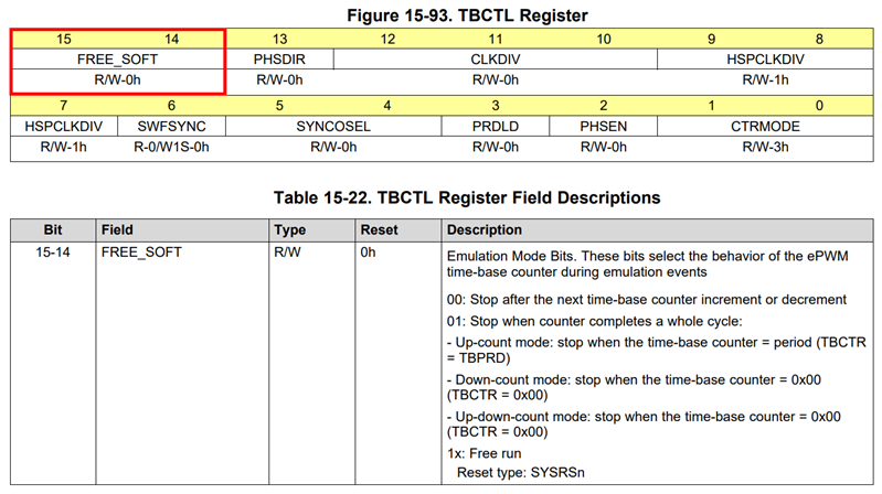

  • Hi Joel,
    I think the FREE_SOFT bit in the TBCTL register will be useful in solving your problem.
    Have you considered using this bit?
    TBCTL Register
    Sangil
