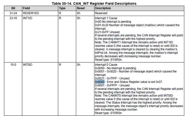

    Namely , I get interrupt, but CAN_getInterruptCause  (CAN_INT Register (Offset = 10h)) changes its behavior.
    Instead of returning "Number of message object which caused the interrupt", which should be number 1 to 32 I get 0x8000.
    Is it expected? What I do wrong?

  • Rasty,
    The function CAN_getInterruptCause essentially reads the register CAN_INT. If you refer to the device TRM (refer to attached snippet) it is given that getting the value 0x8000 implies that there is an error in the CAN operation. So kindly check your work. You can refer to example "can_ex2_loopback_interrupts" to understand how to operate interrupts.

    It looks that for every RX and TX interrupt I get additional interrupt with
    0x8000U in CAN_O_INT           0x10U    // Interrupt Register
    When this happens, I see
    8 in CAN_O_ES            0x4U     // Error and Status Register
    Why I get additional interrupt for each TX and RX events? Is it normal?
    Rasty
  • Randy,
         ISR will be executed twice for every frame, first time for status change and second time for the message object interrupt.
  • Hi
    Is it possible to get rid of unnecessary interrupts?
    Rasty
  • You can disable the status interrupt (bit 2 of CAN_CTL register).
