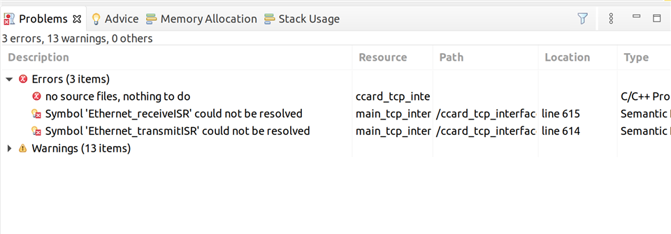

When I try to build my project in Eclipse, I get the following errors:
The first two errors seem to be related to the linker not finding some symbols even though the library is installed, and the symbols seem to be there as verified by the following commands:

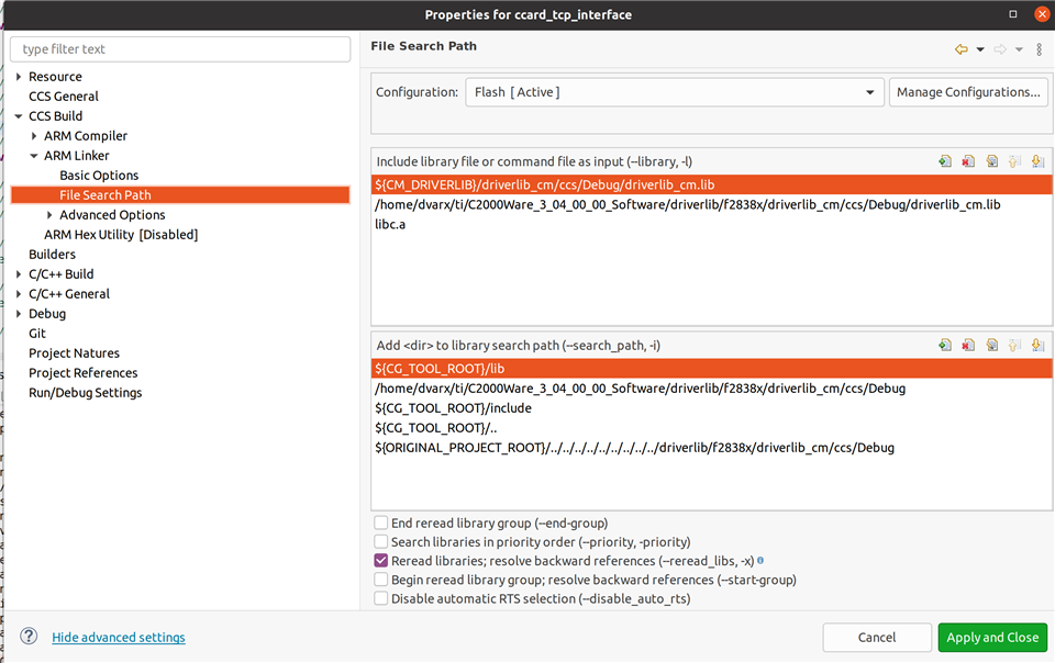

I also include the library in my linker settings in Eclipse:

"/home/dvarx/ti/ccs1030/ccs/tools/compiler/ti-cgt-arm_20.2.4.LTS/bin/armcl" -mv7M4 --code_state=16 --float_support=none -me -O0 --opt_for_speed=0 --define=_FLASH --define=ccs -g --diag_warning=225 --gen_func_subsections=on --abi=eabi --ual -n -z -m"enet_lwip_cm.map" --heap_size=0x1000 --stack_size=2048 -i"/home/dvarx/ti/ccs1030/ccs/tools/compiler/ti-cgt-arm_20.2.4.LTS/lib" -i"/home/dvarx/ti/C2000Ware_3_04_00_00_Software/driverlib/f2838x/driverlib_cm/ccs/Debug" -i"/home/dvarx/ti/ccs1030/ccs/tools/compiler/ti-cgt-arm_20.2.4.LTS/include" -i"/home/dvarx/ti/ccs1030/ccs/tools/compiler" -i"/home/dvarx/ti/C2000Ware_3_04_00_00_Software/driverlib/f2838x/driverlib_cm/ccs/Debug" --reread_libs --warn_sections --xml_link_info="enet_lwip_cm_linkInfo.xml" --rom_model -o "enet_lwip_cm.out" "./comm_interface.obj" "./f2838xif.obj" "./fs.obj" "./httpd.obj" "./lwiplib.obj" "./main_tcp_interface_lwip.obj" "./pinout.obj" "./startup_ccs.obj" "./ustdlib.obj" "../2838x_flash_lnk_cm_lwip.cmd"  -l"/home/dvarx/ti/C2000Ware_3_04_00_00_Software/driverlib/f2838x/driverlib_cm/ccs/Debug/driverlib_cm.lib" -l"/home/dvarx/ti/C2000Ware_3_04_00_00_Software/driverlib/f2838x/driverlib_cm/ccs/Debug/driverlib_cm.lib" -llibc.a
>> ERROR: no source files, nothing to do
Finished building target: "enet_lwip_cm.out"
I am not sure why the linker complains about missing source files since they seem to be provided in this command?
