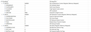

I am trying to port the Universal Motor control lab code (which is built around F280025C) to a TMS320F28379D controller. I did not change the linker command files while porting.
I am getting an error for this function.
// initialize the user parameters
USER_setMotor1Params(obj->userParamsHandle);
My program hits the break point up to to this function but when I try to step in to the function the CCS IDE the run control button is disables and the program counter location is unknown. The CPU reset or restart button are also disabled. When I open the map file, there is no ROM location allocated to USER_setMotor1Params(). How to resolve this issue
