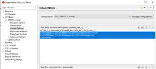

  • I had to include the following paths to the compiler includes to build the project:
    The project builds with the following warnings:
