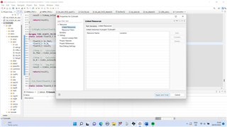

    Please do clarify if I am looking in the wrong location, but I cannot see any .asm mathematic functions in this directory. I also do not see, again, linker command files. Here is a screenshot:
    Looks very different to the project properties for my own project, so there is something wrong possibly with how the installer has set the directories?
    Joel
  • Hi Joel,
    Consider the logN example:
    1. In <C2000Ware>\libraries\math\CLAmath\c28\examples\logN\cla_logN.cla CLA source file, Cla1task1 calls CLAlogN function.
    2. CLAlogN is an optimized assembly function which is defined in <C2000Ware>\libraries\math\CLAmath\c28\source\CLAlogN.asm and gets included in the CLAmath library which was linked with the logN example project.
    The code snippet you included above is an unoptimized C inline function which is a test function to verify that the assembly function is correct by comparing the output of both implementations.
    Ashwini
