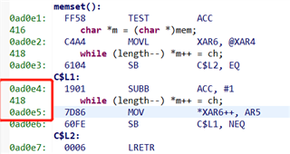

    Another strange thing is that If we try to add some codes in function "Interrupt_illegalOperationHandler" for debug, then CPU1 runs normally.
    static void Interrupt_illegalOperationHandler(void)
        // Something has gone wrong.  The CPU has tried to execute an illegal
        // instruction, generating an illegal instruction trap (ITRAP).
        ESTOP0;
        for(;;)

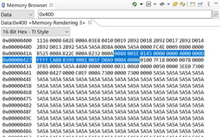

    The stack memory is assigned from 0x400 to 0x800 which belongs to M1 RAM. As I mentioned above, the CPU1 works well if we run the code using debugger. The abnormal occurrence only happened in standalone mode. so I can't step into the code.
    Besides, the chip is secured by DSCM, which means we can't watch the CPU registers(specially, the SP register is 0x0000) and variables in the program when CPU1 gets stuck. The PC register is accessible and it points to the function "Interrupt_illegalOperationHandler". Then we unlock the DSP using CCS, strange things happened. The PC register changed to an illegal address with content 0x0000 and the SP register changed to 0x0202. We found that once we unlock the chip, the PC and SP value will change, no matter the CPU is stack or not. If this is true, how can we know the context data exactly at the moment when the CPU gets stuck.

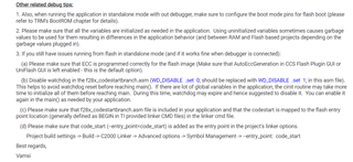

  • Hi Vesgine,
    Please see below snapshot taken from my FAQ link: e2e.ti.com/.../faq-flash---how-to-modify-an-application-from-ram-configuration-to-flash-configuration
    Could you check if any of these are affecting your application?
    Thanks and regards,
    Vamsi
  • Hi Vamsi,
    Thanks for your reply.
    We have complied all the rules you mentioned except the following one:
    "All the sections mapped to Flash are aligned on a 128-bit boundary using ALIGN() directive in the Flash based linker command file"
    In my application, the FLASH sections are aligned on a 64-bit boundary using ALIGN(4). We can test it later. Could you tell us why the sections in FLASH must be aligned on a 128-bit boundary.
    BTW, we didn't find any problem in our earlier products which used TMS320F28377D with FLASH aligned on a 64-bit boundary.

      2) It seems that an illegal interrupt occurs when a SB instruction is executed.
          Here is the context saved after entering the illegal interrupt. We can see that the Return Address is "0xade05". Can we tell from this that an exception occurs when fetch 0xad0e4?
         Then I used different programming methods to implement the same loop assignment, only to find that it entered an illegal interrupt after SB executed.

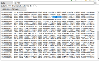

      3) We use 0x400-0x800 as the stack space.  When an exception occurs, there is a lot of data other than the small number of areas where the program performed normal operations. Can you get more useful information from it?

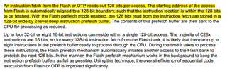

    I found the specification about FLASH-prefetch mechanism from TRM as shown below. And YES, we enabled cache and prefetch mechanism to improve performance of code during initialization.
    If the contents in FLASH are aligned on 64-bit boundary, will this trigger an ITRAP?

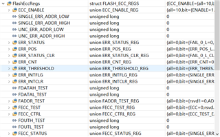

    This does not seem like a flash issue to me.  Few things to check:
    1) Can you check if there is a flash ECC error as well?

    1) I read the "Flash0EccRegs" inside the ITRAP handler, and there seems to be no FLASH ECC error.
    2) I tried to fill the stack with "0x5A5A" first, and found only a small portion was used and no overflow occurred.
