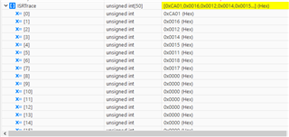

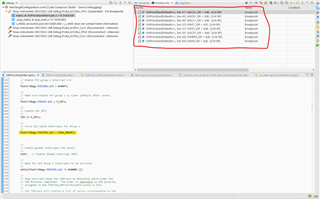

  • Hello StephanS and Veena,
    I reverse the order as you mentioned.
    and here is the results,
    The USER interrupt is the last one executed like it has the lowest priority!

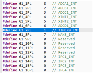

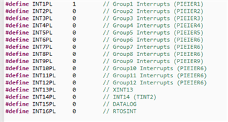

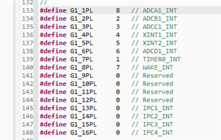

    I made some changes to the order priority in the header file:
    I agree with you, the TRAP instruction is not maskable, but what I am trying to experiment is the ability to execute and interrupt inside the USER interrupt.
    I am trying to make the Timer interrupt trig inside the User interrupt.
    As Stephen mentioned, EINT instruction will enable all the interrupts. Ideally, you should be selecting enabling only those interrupts for which you need higher priority. That is what is done in the SW prioritized interrupts logic. If you look at the interrupt_ex3_sw_prioritization example, you can find that the ISR updates the IER and PIE registers before EINT. The macros M_INT1 and MG1_7 are configured in such a way that it only enables the interrupts which has higher priority than the Timer interrupt. You can use a similar logic to extend these for USER interrupts.
    Veena

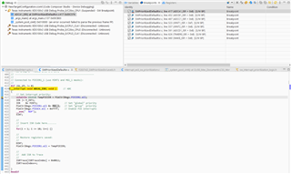

  • Great,
    I am debugging this example to practice this and understand the nesting deeply.
    To do so, I am using the first group with the Timer0 highest interrupt. In the example first case, I am firing the 8 interrupts and I am adding a breakpoint to each interrupt like in the picture below.
    When I click F8, the PC runs to the ADCA1 interrupt, it's not the software's highest priority but, it goes in this interrupt first.

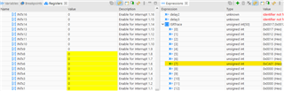

    It's normal for the first time because hardware takes place and the software prioritization will start from the ADCA1_ISR.
    My questions are:
    1. In the second F8 the program counter hit the Timer0 interrupt but before reaching the Timer0 interrupt the PIEIER1.all = 0x00FE.
    It supports having  PIEIER1.all = 0x0040? I couldn't understand, Does the MG1_7 shifting takes more cycles and in this stage, the PIEIER1.all is still not affected?
    2. The 10 cycles for the loop is it mandatory in the interrupts? Do I have to keep this for loop for nesting or is it just for demonstration of CPU load?
    Thank you in advance,
    S.T
  • Can you share the priorities you have configured for each of those interrupts? Are you checking the IER register values just before the EINT statement?
    That is just for the demo. You can remove that and insert the actual ISR code there
    Veena
    In this case, the ISR 1.1 will enable all the other Group1 interrupts (since they have higher priority than INT1.1), hence you see 0xFE. Next it should hit ISR1.2 due to hardware priority and in ISR1.2, only those interrupts with higher priority than itself is enabled, and so on...
    Hope that is clear.
    Veena
