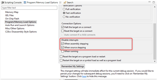

I have a question about the debugging using the xdsv2 used in the LaunchXL pad,
I remark that when I trig an interrupt and continue to step on step (F5) the interrupt is not triggered even if I press F5 more than 10 times and even if I add this "ERTM".
The interrupt is triggered only when I hit F8 and I break the PC in the interrupt service routine.
Does this due to the 14 cycles needed or it's an emulator issue and do I have to activate something in the debugging registers?
