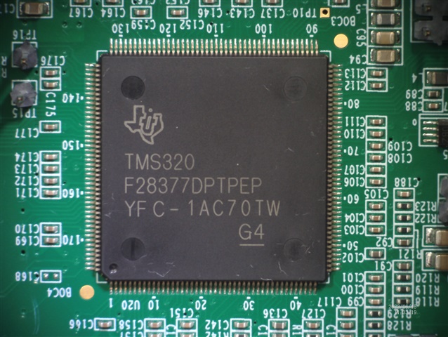

    The -EP material should be form/fit/function equivalent to the non -EP so I've got no reason to suspect that as the root cause, but agree that something is behaving differently here whatever the reason.
    1)Device Information
    Would it be possible to take a picture of the top side of the C2000 device and attach it here?  If you prefer you can just reply back with the characters you see.  This will let me get some basic information on when this material was manufactured, etc.
    I'm assuming that most/all of the 700pcs are from the same range, but if you could note a few that are failing and some that are not failing that will help as well.
    If you have an equivalent from the catalogue device you were previously using that will also be helpful.
    At this point trying to track down any commonality good vs bad that we can use to investigate internally here.

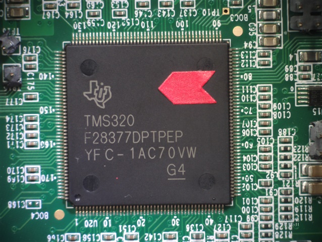

  • Here are the pictures of two of the boards, labeled good and bad. The batch appears to be different, I will have production do a second check of the other chips. Purchasing did a check on the batch purchase and told me they all appear to be the same batch and were ordered/delivered at the same time.
    Bad BoardGood Board
    The programming process is 100% manual. We need to test a number of things and make adjustments to pots prior to firmware programming. Normally the power board has warmed up at this point so we don't believe it is a power stabilization issue.

  • Here are a couple more pictures from Production. Any chips with a red marker are considered bad and marked for potential rework. These are from the same batch.
    Bad BoardGood Board
  • Ben,
    Thanks for the additional info, as you mention these are all from the same batch and date code(last row) indicates these are recent material:  "1A" indicates that these were manufactured in Nov 2021.
