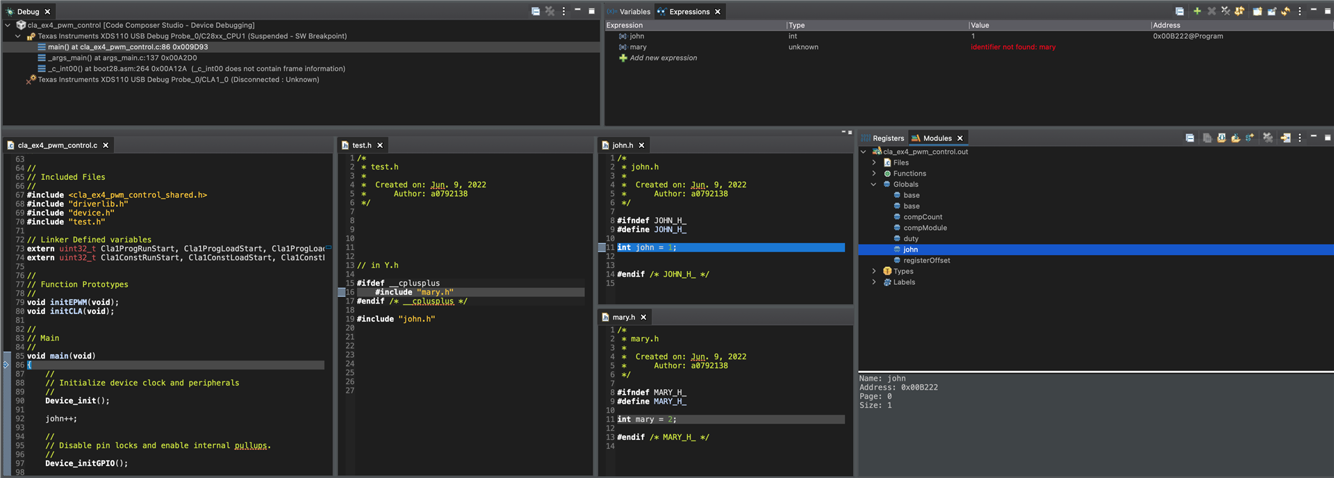

    Here I include test.h from my main c file.  This has the first #ifdef __cplusplus from your file but not the second one which I did not see a purpose for.  In my example test.h includes john.h which just defines a global variable.  I can build this and the global variable is present.

    Here I tweaked the above example to include a mary.h with a different variable if __cplusplus is defined
    Another way to show this is:
    #ifdef __cplusplus
        #include "mary.h"
    #else
        #warn("__cplusplus is not defined");
    #endif /* __cplusplus */
    When I build I will see:
    "../test.h", line 18: warning #1181-D: #warning directive: ("__cplusplus is not defined");

    I am not sure what you are referring to as a compiler bug.  Here I have taken your original source from the first post.  The only thing I changed was to change x.h to john.h.  As you can see john.h is included as the variable it defines is present.  That is correct as the #include is outside of the conditional blocks.
    If I do it like the last post
    Then it will fail to build as john.h is not included as __cplusplus is not defined and my code references the variable.  This is also correct.
    The compiler is behaving correctly.
    If you need to tell if the code is being built for a TI C2000 device you could either define a symbol in your build options and set it based on what you are building for.
    Another option would be to look for one of the predefined symbols that the TI compiler always has such as __TI_COMPILER_VERSION__
    In the above capture, I look for that symbol and if it is present I include john.h.  If it is not I include mary.h.
