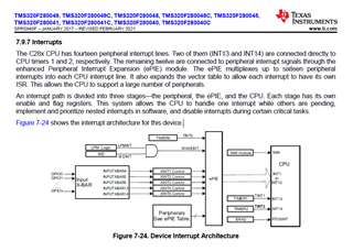

The header file (DSP28_SWPrioritizedIsrLevels.h) required to control ePIE peripheral core priority levels (TRM 3.5.6 Vector Tables) is missing C2000ware V3.04/4.01 DSP folder. The ePIE MASK priory order document web page specifically states header file (DSP28_SWPrioritizedIsrLevels.h) is required.
C28x Interrupt Nesting
Using the MASK Values
Within an interrupt service routine, the global and group priority can be changed by software to allow other interrupts to be serviced. The steps are the same as described before. The only difference is the mask values for IER and PIEIERx have been managed in the DSP28_SWPrioritizedIsrLevels.h file.
Why was the header file (DSP28_SWPrioritizedIsrLevels.h) remove from C2000ware?
The peripherals all send ePIE a core priory value in order that higher priority groups are not stomped on by lower slower priority interrupts. Likewise, it should stop a lower priority peripheral from over running a higher priority group CPU instruction decode.
Currently without the header file SCIB INT9.4 overruns ADCA1 INT1.1 (higher core priority) before reaching SW Clear ACK placed at the bottom of INT1.1 ISR.
 Why is the peripheral core priority values being ignored by ePIE and the CPU?

    The hardware priorities in C2000 devices are fixed and nesting is disabled by default. Interrupt nesting and customizing priorities is achieved through software.
    Once the C28x core branches to an ISR code, the global interrupt is disabled by hardware. In software we are re-enabling the interrupts and we disable all those interrupts for which we have assigned a lower priority (in SW). This will ensure only interrupts for which we have configured higher priority can preempt an ISR
    In case of the interrupt_ex3_sw_prioritization example, we have configured CPUTimer interrupts for which the hardware priorities are T0>T1>T2. In software, we configure the priorities as T2>T1>T0. If all 3 interrupts occur at the same time, as per the hardware priorities T0 ISR is hit first. But in the ISR, we re-enable interrupts, resulting in other interrupts to be serviced before T0.

  • Probably the following document would give more details.
    https://software-dl.ti.com/C2000/docs/c28x_interrupt_nesting/html/index.html
    Definitely, PIE is handling and is responsible for branching to ISR function when an interrupt occurs. In SW, we are manipulating the IER registers to achieve interrupt nesting. By hardware, once the interrupt ISR is entered, the global interrupt is disabled (INTM is set) and the corresponding IER bit is also reset. In the ISR code, we are reenabling that IER bit ( IER |= M_INT9;) and disabling all the lower priority interrupts ( IER &= MINT9;) and re-enabling the global interrupt (EINT) to achieve interrupt nesting for higher priority interrupts.
    MG9_4  and PIE_IER9_INTX4  is NOT the same. MG9_4  is constructed in such way that all interrupts in Group 9 which has higher priority than  9.4 is set
    M_INT9 -> Bit 9 is set
    MINT9 -> Bits corresponding to all INTs with higher priority than INT9 is set
    I would highly recommend to use the code snippets available in the  f28004x_sw_prioritized_defaultisr.c for the correct functioning of interrupt nesting
