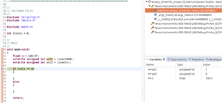

TMS320F280039C: isnan() is causing illegal operation
Part Number: TMS320F280039C
I'm trying to check if a number is NaN using the function isnan in math.h but when it runs it ends up in the Interrupt_illegalOperationHandler(). I've tried using all three of these individually as well in _defs.h
I simplified a function just to test isnan and now this is the function ending up in the illegalOperationHandler()
If I comment out isnan the function works fine. I have math.h included in the file. Do you have any ideas what is going on here?
