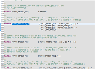

We have custom board with  TMS320F28384D with external crystal 20MHZ.,
we have changed  USE_20MHZ_XTAL in predefined symbol with respect to document control card and also already mentioned in device.c file.. in our project...
But in our project file, when we click   (CTRL + DEVICE_SETCLOCK_CFG ) in device.c file..
its goes to 25MHZ_XTAL(else part in device.h).....  Cystal configuration not  linking with ""USE_20MHZ_XTAL"" ...
// Set up PLL control and clock dividers
SysCtl_setClock(DEVICE_SETCLOCK_CFG);
we are  using c2000 3.4  sdk version and latest CCS... please confirm how to  USE_20MHZ_XTAL  in our project....
