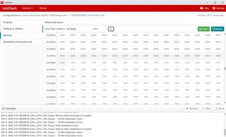

I am working with the TMS320F280037C device and I try to read the User configurable OTP Bank 1(0x78400 - 0x787FF) using Uniflash(Version: 7.1.0.3796) and XDS200USB debugger. From the datasheet it seems, that this locations can be programmed/readed as a normal part of flash. But when I try to read this locations I am not able to do it. The addresses from the 0x78400 to 0x787FF is marked as "????", what means that they are inaccessible:
Is there error in Uniflash or this device doesn't have this OTP(however datasheet say that OTP Bank 1 is implemented)?
