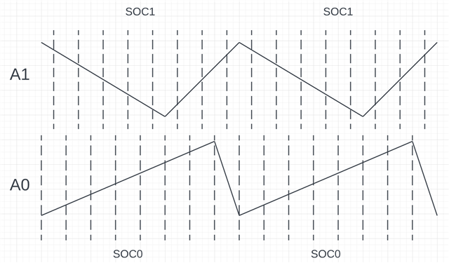

    I don't think that sort of sampling scheme fits my needs. To illustrate, this is how things are currently set up, showing one pair of signals (A0 and A1) converted by ADCA. A0 is converted by SOC0, and A1 is converted by SOC1. Each is triggered by a separate ePWM SOC event so that SOC0 and SOC1 are interleaved evenly
    I want to measure the average of the waveform within one period, but as you can see, with just one sample per period I can see large errors which depend on the timing of the sample and the slopes of my sawtooth waveform.

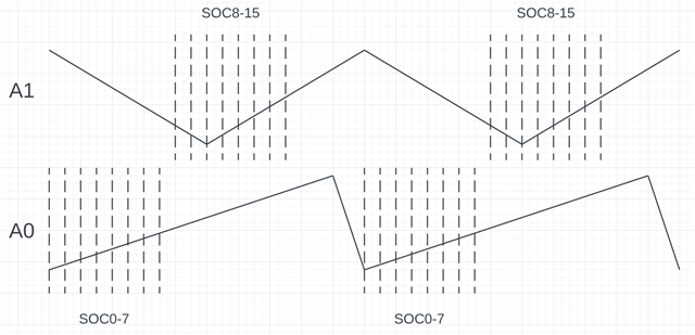

    As I understand it, your proposed scheme would look like below. More samples, but since the samples aren't evenly distributed I still get large error even after averaging the groups of samples. If had the SOCs alternate between A0 and A1 after each sample then it might improve somewhat, but still not very accurate.
    What I want is shown below (using just SOC0 and SOC1 in this case). The samples are evenly distributed, so I get the best possible rejection of the ripple.

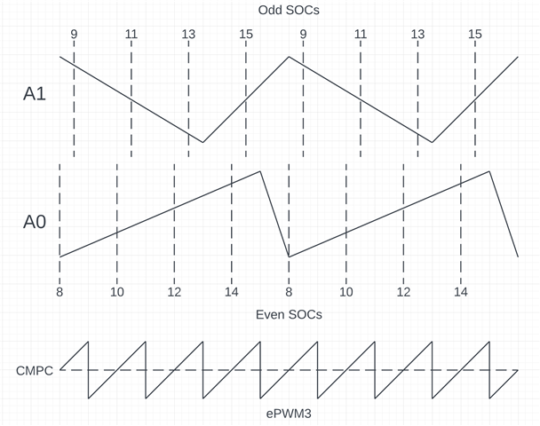

    Here's the sample timings I hope to get out of it. I also show the ePWM3 counter for reference. The sampling of the ADC itself is not even, but the sampling of each channel is even, which is what really matters, I believe (so long as all SOCs on the other ADCs line up exactly).
    I tried it out a bit on Friday and saw that I was getting correct looking results in AdcaResultRegs 8-15, but I can't yet tell what the actual timing of the samples are. Need to try a much slower burst trigger so I can see the process in the debugger.
