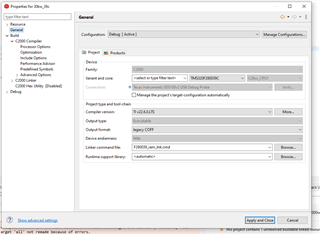

Hi team,
We are trying to integrate ADC and PWM codes one from driverlib example and other from device support, I am getting the below error can you please help to solve this?
" No rule to make target 'D:/ccs/eclipse/c2000ware/driverlib/f28003x/driverlib/ccs/Debug/driverlib.lib', needed by 'all'."

Below are my project settings
    It looks like the path of driverlib.lib is not right.
    Based on build console log, it should be "C:/ti/c2000/C2000Ware_MotorControl_SDK_4_00_00_00/c2000ware/driverlib/f28003x/driverlib/ccs/Debug/driverlib.lib"
    Please check the project include path or driverlib.lib file in the project. It is a linker file. Check the path of linked file.
    Are you building in COFF format? Probably driverlib.lib file is in EABI format.
