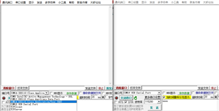

yes,i can see two COM ports in my OS.i used serial debug tool to open two device,but they can't write to each other.my serial tool device signal level is 3.3V.
what i want to complete is using XDS110 DEBUG PEROBE device to transmit CMD.
here is my debug tool interface on OS

the receiver is not a MCU, i used my UART tool just like this picture to receive XDS110 debug probe,this device's signal level is 3.3v and i had been used it to transmit message to MCU.

the setting for Rx device is same,Baud =115200,Data Bits = 8, Parity =None Stop Bits=1.
Hu,
Looking at the picture I think you need to swap the jumper wires on either the XDS110 break board or the other PCB. TX from the XDS110 should go to Rx on the blue PCB and Rx from the XDS110 should go to Tx to the blue PCB.
Right now it looks like Tx goes to Tx and Rx goes to Rx, which is incorrect.
