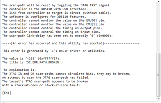

JTAG connect is fail,is it broken?
I just get the demo board today.

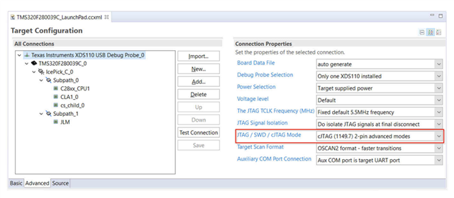

Can you check if you are using 2-pin cJTAG mode?
Launch the LAUNCHXL-F280039C Target Configuration file and connect to the F28003x device. Ensure that the Target Configuration file is configured to use the 2-pin cJTAG advanced configuration.
