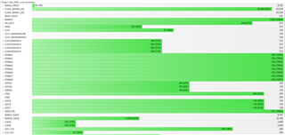

I have a confusion on CCS memory allocation where it is showing Flash bank 0 and Flash bank 1 having 65534 kb each where in data sheet of TMS320F280049C having total 256 kb of flash.
1. Is there any reserve flash is there where we cant able to flash or see it in CSS.
2. If my code is will over flow from bank 0, will it link to bank 1 or it will throw a error cant be flashed? if this is occur how can we merge 2 banks to single bank for flashing ?
I added up a Screenshot of the memory allocation block.
Pratyush,
There will be linker error is the output section is more than memory available. There is a way to split the output section in multiple memory ranges. Please take a look at this link to understand:
https://software-dl.ti.com/ccs/esd/documents/sdto_cgt_Linker-Command-File-Primer.html
