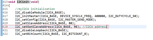

  • I do see a 60 thank you so much I was confused about that and I am trying to connect a dummy i2c device (an arduino uno) just to see if the address was even being found on the bus and it was not, for my main project I am trying to connect an RTC but I am guessing my problem starts with the fact that no I2C device other than ones from the chip are being found and I have checked that Im using the right pins
  • also what line of code is it that sets the I2C master adress to 0x60
  • I have highlighted section of code which programs I2CA address (0x60 = 96 in decimal)
    If the F280049 I2C doesn't receive ACK signal from arduino uno I2C then its address wouldn't be visible in AvailableI2C_slaves. Then the problem is with arduino uno I2C configuration.
