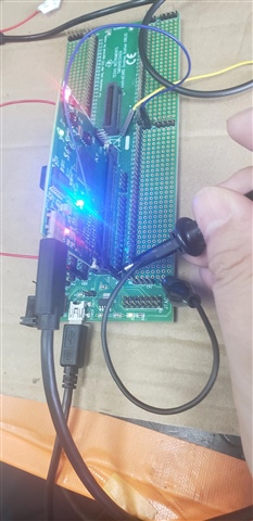

Dear team:
HW: TMDSCNCD280039C + TMDSHSECDOCK
SW: C:\ti\c2000\C2000Ware_4_01_00_00\driverlib\f28003x\examples\adc\adc_ex1_soc_software.c

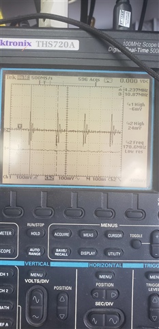

My customer measured the ADC pin of the chip with an oscilloscope based on the above configuration, and found that the pin would have a clutter with an amplitude of about 200mV /4mhz when it was suspended.
And when the customer modifies the conversion time of ADC module, the frequency of clutter will also change.
Is this waveform caused by external interference or the internal circuit characteristics of ADC module?
