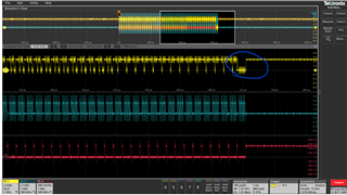

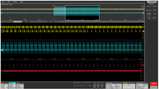

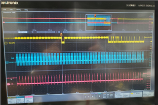

1) I am sending 47 bytes of 0xFF from slave to master and as you can see I have some noise, and some of the bytes are changing as can seen below on the scope trace. Could anything in my configuration cause this? I changed from sending the data I want to 47 bytes of all 0xFF because I suspected I had some noise changing my data. Both transfer and receive are working but on both sides, I have noise changing bytes of data.

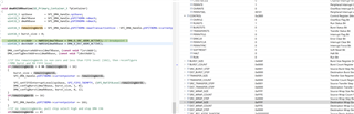

This is my buffer being sent linked to TxDMA - as you can see it is 0xFF - so the data being sent is what I expect

  • 1) I am sending 47 bytes of 0xFF from slave to master and as you can see I have some noise, and some of the bytes are changing as can seen below on the scope trace. Could anything in my configuration cause this?
    Noise seen on the scope is a board artifact and has nothing to do with SPI / DMA configuration. You should be able to see this noise even it you toggle GPIOs quick enough.
    2) A setup question - Why does the slave need a baud rate in SPI_setConfig()? Should it not just transmit data on the rising edge of the clock?
    Yes, for SPI slave configuration, you don't need to configure baud rate.
  • Hey Manoj,
    Thanks for the reply. I'm not asking about noise on the scope. I'm asking why I am sending packets of 0xFF and the data is changing. This is the "noise" I am referring to.
    Do you see anything wrong in my configuration causing the 0's here? The data in the debugger being sent is all 0xFF. There are no 0's.
  • Derek,
    Are you talking about higlighted signal as noise? From the oscilloscope snapshot, it looks like 1st 32 bytes did give you desired results. After each DMA burst, check whether buffer  is filled right data. That would be 1st step. We need to check the TX buffer pointer is getting corrupted.

  • I'm talking about the SlaveTx on channel 1 - the TxBuffer is 0xFF in all 47 bytes but this data seems to be changing to a third of the way in and the final third. I circled this below.
    This is the value in DMATXbuff being sent - all bytes are 0xFF

  • I'm getting a little bit closer - it looks like the corrupt data being transmitted is from my RxBuffer. It's the data I'm receiving from the master.
    Below shows what the master is sending to this device:
    This is what I the master is receiving
    The TxBuffer holds all 0xFF so it does not seem to be getting overwritten but somehow the DMA Tx / Rx wires seem to be getting crossed.

    Here is what Master is sending
    And here is what is being received - as you can see it is an echo back of what it is sending - I feel like somehow the SPI driver is defaulting to echoing back what is sent for some reason and that's where the data is getting corrupted.
  • I enabled loopback mode as a test and switched my SPI config to Master and every time I read back the packets of 0xAA which I am sending
    I also enabled sending not all 0xAA but the data I want to send and also receive it on my RxBuffer

    I think most of my issue here is also related to interrupt nesting -
    I added this before triggering another Tx burst and the data is mostly correct now.
        else
            //DMA SW trigger to initiate SPI transaction - note since we're using slave config this will just fill Tx FIFO buffer
            EINT; // Enable interrupts
            DMA_forceTrigger(dmaTXbase);
            pContainer->debugCnt++;
        //Acknowledge CPU interrupt flag
        Interrupt_clearACKGroup(INTERRUPT_ACK_GROUP7);
    I'm trying to send 47 bytes of 0xDC to my master as a test and this is what it is receiving
    What I've noticed is that if I pause the debugger or not initiate the DMA to trigger SPI the master somehow gets the data it sends looped back unless the DMA has been working then it keeps receiving the last packet. Not sure how, since the MCU is paused by a breakpoint.
    However, normally when the CS goes high, the Tx line from the slave also goes high. When I send the 0x06 bad data to the master this is the only case this does not happen. It makes me think that this is related to the SPI not working here. Maybe I need to reset SPI between bursts. The 0x06 is also after 1 16 byte transfer before I start the next 15 byte transfer.
  • Looking at the DMA CH5 registers which are used for the transfer I see this. First of all this is the ch6 ISR - comments show breakpoint 1 and breakpoint 2.
    void dmaRXISRRoutine(GE_Primary_Container_t *pContainer)
        uint32_t spibase        = SPI_DMA_Handle.spibase;
        uint32_t dmaTXbase      = SPI_DMA_Handle.pSPITXDMA->dmach;
        uint32_t dmaRXbase      = SPI_DMA_Handle.pSPIRXDMA->dmach;
        uint16_t remainingWords = SPI_DMA_Handle.pSPITXDMA->maxTransactionSize - SPI_DMA_Handle.pSPITXDMA->currentpointer;
        uint16_t burst_size = 0;
        uint16_t srcAddr  = HWREGH(dmaTXbase + DMA_O_SRC_ADDR_ACTIVE); // breakpoint 1
        uint16_t destAddr = HWREGH(dmaRXbase + DMA_O_DST_ADDR_ACTIVE);
        DMA_configSourceAddress(dmaTXbase, (const void *)srcAddr);
        DMA_configDestAddress(dmaRXbase, (const void *)destAddr);
        //If the remainingWords is non-zero and less than FIFO level (16U), then reconfigure
        //DMA burst and RX FIFO level
        if(remainingWords > 0 && remainingWords < 16)
            burst_size = remainingWords;
            SPI_DMA_Handle.pSPITXDMA->currentpointer += remainingWords;
            SPI_setFIFOInterruptLevel(spibase, SPI_FIFO_TXEMPTY, (SPI_RxFIFOLevel)remainingWords);
            DMA_configBurst(dmaTXbase, burst_size, 1, 0);

    Now, when I'm at breakpoint 1: currentPointer = 32, remainingWords = 15, RUNSTS = 1, TRANSFERSTS = 1.
    Should I be trying to start a transfer if TRANSFERSTS = 1?
  • It looks like the TRANSFERSTS is always 1. Does it go to 0 when the transfer completes?
    I was thinking maybe the issue is that I am starting another transfer before the last was completed.
  • It looks like TRANSFERSTS should clear whenever TRANSFER_COUNT = 0.
    It does not look to be doing that.
  • It looks like you have made some progress with respect to this debug.
    When TRANSFERSTS is set to 1, it means DMA is in middle of a transfer. Did you check whether all the bytes are transferred?
  • That's the interesting part - if I set a while loop like this:
    while(DMA_getTransferStatusFlag(dmaTXbase) == 1);
    The TRANSFERSTS never goes to 1, and I get stuck in the while loop. It seems like all the bytes are not being transferred sometimes.
    That would make sense why I'm seeing some echo back on the master side because looking at other threads that is expected if the SPI is not being serviced completely.
    These are the SPIA and SPIA Tx FIFO registers. Maybe I need to enable TXFIFO interrupt?
    Also if I just want 1 transfer, I set  DMA_configTransfer(dmaTXbase, 1, 1, 0); like this? Looks like this will cause TRANSFER_SIZE = 0?
  • Any feedback here on why the bytes would not be getting transferred and TRANSFERSTS  would be 1?

  • Hey Manoj, any ideas why I would get getting 17 bytes per transmission instead of 16?
  • I have almost exactly what I want now. I am just missing the very last byte - it is always 0.

    Also on the 2nd 16 byte packet I had to change burst size to 16+1 to keep it from sending 17 bytes. I do not understand why?
    Doing this gives me exactly what I want for the first 2 16 bit DMA packets BUT on the 3rd 15 bit packet bit 15 is 0.
    In this picture byte 46 and 47 are not shown.
    On the scope I see byte 47 missing.
    I am changing the transfer to 15 bits this way in the DMA Rx ISR:

  • Hey Manoj,
    So we can see which bytes are getting sent and which are not, I numbered each byte of the 47 bytes so they count up. The numbering scheme is as follows below:
    DMATxbuff[0] = A0, DMATxbuff[15] = 0xAF
    DMATxbuff[16] = C0, DMATxbuff[31] = 0xCF
    DMATxbuff[32] = E0, DMATxbuff[46] = 0xEE
    Test 1 - Set BURST_SIZE to what it should be:
    Packet1 (0xA0-0xAF) - BURST_SIZE  = 15 (I want 16 bytes)
    Packet2 (0xC0-0xCF) - BURST_SIZE  = 15 (I want 16 bytes)
    Packet3 (0xE0-0xEE) - BURST_SIZE = 14 (I want 15 bytes)
    This is what I get:
    Packet 1 = good
    Packet 2 sends the 1st byte 0xC0 twice - any idea what could cause this?
    Packet 3 is missing 0xEE - I assume because packet 2 sent 0xC0 twice?
    Test 2 - Set BURST_SIZE on packet 2 to 16
    Packet2 (0xC0-0xCF) - BURST_SIZE  = 16 (I want 16 bytes)
    This is what I get:
    Packet 1 = good
    Packet 2 = good
    Packet 3 = missing byte 1 (0xE1) - This causes last byte to be 0x00

  • I feel like the srcStep is being incremented  too far after my first transfer. How would I decrement the source step by 1? I think after I transfer packet 1 it increments past byte 0 of packet 2.
  • Actually I figured out how to do that I think - it just causes 0xC1 of packet 2 to get sent twice instead of 0xC0.
        // Increment source address
        uint16_t srcAddr  = HWREGH(dmaTXbase + DMA_O_SRC_ADDR_ACTIVE) + 1;
  • As another test to see which transfer is sending 0xC0 (byte 0 of packet 2) twice I did the following:
        DMATXbuff[16] = 0xB000;
        DMA_configAddresses(dmaTXbase, (uint16_t *)(spibase + SPI_O_TXBUF), DMATXbuff);
        DMA_configBurst(dmaTXbase, BURST, 1, 0);
        DMA_configTransfer(dmaTXbase, TRANSFER, 1, 0);
        DMA_configMode(dmaTXbase, DMA_TRIGGER_SPIATX, DMA_CFG_ONESHOT_DISABLE | DMA_CFG_CONTINUOUS_ENABLE |
                                                      DMA_CFG_SIZE_16BIT);
        // DMA SW trigger to start SPI transaction using DMA
        // Configure the TX DMA to interrupt at the end of transmission
        DMA_setInterruptMode(dmaTXbase, DMA_INT_AT_END);
        //  Enable the TX DMA interrupt
        DMA_enableInterrupt(dmaTXbase);
        //  Enable the TX DMA to allow a start of transfer
        DMA_enableTrigger(dmaTXbase);
        // Force for 16 bits to fill TX FIFO
        DMATXbuff[16] = 0xC000;
        // Switch trigger to RX - we want Tx to synchronize with Rx
        DMA_configMode(dmaTXbase, DMA_TRIGGER_SPIARX, DMA_CFG_ONESHOT_DISABLE | DMA_CFG_CONTINUOUS_ENABLE |
    0xB0 does not appear after the DMA_forceTrigger() to send the first 16 bytes to fill the TX FIFO buffer.
    So it seems for whatever reason, the second DMA transfer sends the first byte twice.
