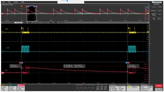

TMS320F280039C: Issues with SPI TX FIFO Interrupts Not triggering fast enough
Part Number: TMS320F280039C

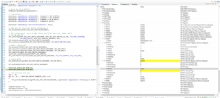

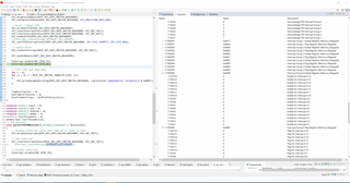

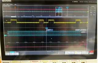

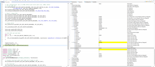

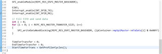

I am requesting SPI master FIFO transfers by enabling the TX interrupt every ~5000 CPU cycles. However, I am seeing that the time from when I enable the TX FIFO interrupt to the interrupt triggering is ~15000 CPU cycles.
Here is how I'm requesting a transfer:
// Processes
// Start sequence of SPI Master read/write register operations to Resolver chip - Blocking
void SpiMaster_StartTransfer(GE_Primary_Container_t *pContainer, uint32_t command)
    TxEnd = GetProfilerCycles();
    TxTime = CalcProfilerTime(TxStart, TxEnd);
    pContainer->mpSpiMaster->mDataRecv = 0;
    // Reset Rx and Tx Buffers
    SPIMaster_ResetBuffers(pContainer);
    // TransferData
    pContainer->mpSpiMaster->mTxData[0] = (command >> 24) & 0xFFU;
    pContainer->mpSpiMaster->mTxData[1] = (command >> 16) & 0xFFU;
    pContainer->mpSpiMaster->mTxData[2] = (command >> 8) & 0xFFU;
    pContainer->mpSpiMaster->mTxData[3] = (command & 0xFFU);
    pContainer->mpSpiMaster->mIsTransferCompleted = false;
    // Reset FIFO
    SPI_disableFIFO(REPC_RES_DSPI_MASTER_BASEADDR);
    SPI_enableFIFO(REPC_RES_DSPI_MASTER_BASEADDR);
    SPI_setFIFOInterruptLevel(REPC_RES_DSPI_MASTER_BASEADDR, SPI_FIFO_TXEMPTY, SPI_FIFO_RX4);
    // Enable TxFIFO
    SPI_enableInterrupt(REPC_RES_DSPI_MASTER_BASEADDR, SPI_INT_TXFF);
    SPI_enableInterrupt(REPC_RES_DSPI_MASTER_BASEADDR, SPI_INT_RXFF);
    TxStart = GetProfilerCycles();
    Tx2Start = GetProfilerCycles();
volatile int32_t start = 0;
volatile uint32_t end = 0;
volatile uint32_t RxDelay = 0;
// ISR Routines
void spiTxFIFOISRRoutine(GE_Primary_Container_t *pContainer)
    Tx2End = GetProfilerCycles();
    Tx2Time = CalcProfilerTime(Tx2Start, Tx2End);
    int i = 0;
    for (i = 0; i < REPC_RES_MASTER_TRANSFER_SIZE; i++)
        SPI_writeDataNonBlocking(REPC_RES_DSPI_MASTER_BASEADDR, ((pContainer->mpSpiMaster->mTxData[i] & 0x00FF) << 8));
    // Do nothing on Tx (we initiate this manually)
    SPI_clearInterruptStatus(REPC_RES_DSPI_MASTER_BASEADDR, SPI_INT_TXFF);
    Interrupt_clearACKGroup(INTERRUPT_ACK_GROUP6);
    // Disable interrupt until next time we're ready to send
    SPI_disableInterrupt(REPC_RES_DSPI_MASTER_BASEADDR, SPI_INT_TXFF);
    start = GetProfilerCycles();
void spiRxFIFOISRRoutine(GE_Primary_Container_t *pContainer)
    if(!pContainer->mpSpiMaster->mIsTransferCompleted)
        // We should get 32 bits back
        int i = 0;
            pContainer->mpSpiMaster->mRxData[i] = (SPI_readDataNonBlocking(REPC_RES_DSPI_MASTER_BASEADDR) & 0x00FF);
        pContainer->mpSpiMaster->mIsTransferCompleted = true;
        end = GetProfilerCycles();
        RxDelay = CalcProfilerTime(start, end);
    SPI_clearInterruptStatus(REPC_RES_DSPI_MASTER_BASEADDR, SPI_INT_RXFF);
    SPI_disableInterrupt(REPC_RES_DSPI_MASTER_BASEADDR, SPI_INT_RXFF);

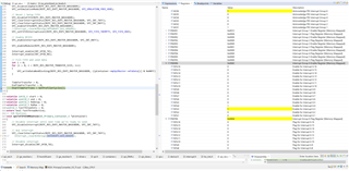

Here is my initialization code:
// Init SPI1 Interface to resolver
void SPIMaster_Init(GE_Primary_Container_t *pContainer)
    // Register interrupt ISRs
    Interrupt_register(INT_SPIB_TX, &spiBTxFIFOISR);
    Interrupt_register(INT_SPIB_RX, &spiBRxFIFOISR);
    // Must put SPI into reset before configuring it
    SPI_disableModule(REPC_RES_DSPI_MASTER_BASEADDR);
    // SPI configuration. Use a 12.5MHz SPICLK and 32-bit word size, 25MHz LSPCLK
    // Rising edge SPI
    SPI_setConfig(REPC_RES_DSPI_MASTER_BASEADDR, REPC_RES_DSPI_MASTER_CLK_SRC, SPI_PROT_POL0PHA0,
                  SPI_MODE_MASTER, REPC_RES_TRANSFER_BAUDRATE, 8U);
    SPI_disableLoopback(REPC_RES_DSPI_MASTER_BASEADDR);
    SPI_setEmulationMode(REPC_RES_DSPI_MASTER_BASEADDR, SPI_EMULATION_FREE_RUN);
    // Configuration complete. Enable the module.
    SPI_enableModule(REPC_RES_DSPI_MASTER_BASEADDR);
    // Enable interrupts
    Interrupt_enable(INT_SPIB_TX);
    Interrupt_enable(INT_SPIB_RX);
	// Init Master Buffers to 0
	// Init Control Variables

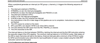

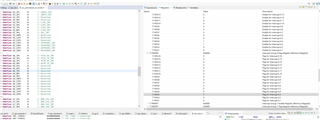

I thought maybe it was a priority issue. I'm requesting transfers from Group1 ADCA1_INT with priority 12 so I set my priority for Group 6 SPIB_TX and SPIB_RX to 6.

Do you have any ideas what I'm doing to cause the TX FIFO interrupt to take so long to trigger?
  • Derek,
    Did you try disabling other peripheral interrupts and see whether the problem goes away?
    Manoj
  • Hey Manoj,
    Thanks for the reply! I'm having issues with 2 different SPI interfaces at the same time. I appreciate the help!
    I think this is an interrupt priority issue. Both TX and RX FIFO interrupts are in group 6. I cannot start enter the Rx or Tx interrupt until I acknowledge the group 6 interrupt already active for Tx or Rx.
    If I move my  Interrupt_clearACKGroup(INTERRUPT_ACK_GROUP6); function from the bottom to top of my ISR, this allows 2 transfers to be sent.

    What I need to understand now is why CS does not go high between the 2 32 bit transfers:
  • Ok, I think my SPIA interrupt was interfering with my SPIB interrupt. If I move SPIB to priority 6 and SPIA to priority 7 then I can get 2 transfers per 250us tick.
    The yellow trace is the Tx and the pink trace is the Rx. The Rx looks like I expect but it seems like RxFIFO is missing the Rx data. The Rx comes the same time as the Tx and the Tx FIFO interrupt is active so I wonder if that's the issue - Since Tx and Rx are in the same group how would I trigger Rx while Tx is active?

    #ifdef __cplusplus
    extern "C" {
    #endif
    // Mask for interrupt groups
    #define M_INT1      0x0001  // INT1 Mask
    #define M_INT2      0x0002  // INT2 Mask
    #define M_INT3      0x0004  // INT3 Mask
    #define M_INT4      0x0008  // INT4 Mask
    #define M_INT5      0x0010  // INT5 Mask
    #define M_INT6      0x0020  // INT6 Mask
    #define M_INT7      0x0040  // INT7 Mask
    #define M_INT8      0x0080  // INT8 Mask
    #define M_INT9      0x0100  // INT9 Mask
    #define M_INT10     0x0200  // INT10 Mask
    #define M_INT11     0x0400  // INT11 Mask
    #define M_INT12     0x0800  // INT12 Mask
    #define M_INT13     0x1000  // INT13 Mask
    #define M_INT14     0x2000  // INT14 Mask
    #define M_DLOG      0x4000  // DLOGINT Mask
    #define M_RTOS      0x8000  // RTOSINT Mask
    // Interrupt Enable Register Allocation:
    // Interrupts can be enabled/disabled using the CPU interrupt enable register
    // (IER) and the PIE interrupt enable registers (PIEIER1 to PIEIER12).
    // Set "Global" Interrupt Priority Level (IER register):
    // The user must set the appropriate priority level for each of the CPU
    // interrupts. This is termed as the "global" priority. The priority level
    // must be a number between 1 (highest) to 16 (lowest). A value of 0 must
    // be entered for reserved interrupts or interrupts that are not used.
    // Note: The priority levels below are used to calculate the IER register
    //       interrupt masks MINT1 to MINT16.
    // Note: The priority levels shown here may not make sense in a
    //       real application.  This is for demonstration purposes only!!!
    //       The user should change these to values that make sense for
    //       their application.
    // 0  = not used
    // 1  = highest priority
    // 16 = lowest priority
    #define INT1PL      12       // Global Priority for Group1 Interrupts
    #define INT2PL      0        // Global Priority for Group2 Interrupts
    #define INT3PL      0        // Global Priority for Group3 Interrupts
    #define INT4PL      0        // Global Priority for Group4 Interrupts
    #define INT5PL      0        // Global Priority for Group5 Interrupts
    #define INT6PL      6        // Global Priority for Group6 Interrupts
    #define INT7PL      7        // Global Priority for Group7 Interrupts
    #define INT8PL      0        // Global Priority for Group8 Interrupts
    #define INT9PL      15        // Global Priority for Group9 Interrupts
    #define INT10PL     0        // Global Priority for Group10 Interrupts
    #define INT11PL     0        // Global Priority for Group11 Interrupts
    #define INT12PL     14        // Global Priority for Group12 Interrupts
    #define INT13PL     0        // Global Priority for INT13 (TINT1)
    #define INT14PL     0        // Global Priority for INT14 (TINT2)
    #define INT15PL     0        // Global Priority for DATALOG
    #define INT16PL     0        // Global Priority for RTOSINT
    // Set "Group" Interrupt Priority Level (PIEIER1 to PIEIER12 registers):
    // The user must set the appropriate priority level for each of the PIE
    // interrupts. This is termed as the "group" priority. The priority level
    // Note: The priority levels below are used to calculate the following
    //       PIEIER register interrupt masks:
    //       MG1_1 to MG1_16
    //       MG2_1 to MG2_16
    //       MG3_1 to MG3_16
    //       MG4_1 to MG4_16
    //       MG5_1 to MG5_16
    //       MG6_1 to MG6_16
    //       MG7_1 to MG7_16
    //       MG8_1 to MG8_16
    //       MG9_1 to MG9_16
    //       MG10_1 to MG10_16
    //       MG11_1 to MG11_16
    //       MG12_1 to MG12_16
    // 0  = not used
    #define G1_1PL      12       // ADCA1_INT
    #define G1_2PL      12       // ADCB1_INT
    #define G1_3PL      12       // ADCC1_INT
    #define G1_4PL      14       // XINT1_INT
    #define G1_5PL      14       // XINT2_INT
    #define G1_6PL      0       // Reserved
    #define G1_7PL      14       // TIMER0_INT
    #define G1_8PL      0       // WAKE_INT
    #define G1_9PL      0       // Reserved
    #define G1_10PL     0       // Reserved
    #define G1_11PL     0       // Reserved
    #define G1_12PL     0       // Reserved
    #define G1_13PL     0       // Reserved
    #define G1_14PL     0       // Reserved
    #define G1_15PL     0       // Reserved
    #define G1_16PL     0       // Reserved
    #define G2_1PL      0       // EPWM1_TZ_INT
    #define G2_2PL      0       // EPWM2_TZ_INT
    #define G2_3PL      0       // EPWM3_TZ_INT
    #define G2_4PL      0       // EPWM4_TZ_INT
    #define G2_5PL      0       // EPWM5_TZ_INT
    #define G2_6PL      0       // EPWM6_TZ_INT
    #define G2_7PL      0       // EPWM7_TZ_INT
    #define G2_8PL      0       // EPWM8_TZ_INT
    #define G2_9PL      0       // Reserved
    #define G2_10PL     0       // Reserved
    #define G2_11PL     0       // Reserved
    #define G2_12PL     0       // Reserved
    #define G2_13PL     0       // Reserved
    #define G2_14PL     0       // Reserved
    #define G2_15PL     0       // Reserved
    #define G2_16PL     0       // Reserved
    #define G3_1PL      0       // EPWM1_INT
    #define G3_2PL      0       // EPWM2_INT
    #define G3_3PL      0       // EPWM3_INT
    #define G3_4PL      0       // EPWM4_INT
    #define G3_5PL      0       // EPWM5_INT
    #define G3_6PL      0       // EPWM6_INT
    #define G3_7PL      0       // EPWM7_INT
    #define G3_8PL      0       // EPWM8_INT
    #define G3_9PL      0       // Reserved
    #define G3_10PL     0       // Reserved
    #define G3_11PL     0       // Reserved
    #define G3_12PL     0       // Reserved
    #define G3_13PL     0       // Reserved
    #define G3_14PL     0       // Reserved
    #define G3_15PL     0       // Reserved
    #define G3_16PL     0       // Reserved
    #define G4_1PL      0       // ECAP1_INT
    #define G4_2PL      0       // ECAP2_INT
    #define G4_3PL      0       // ECAP3_INT
    #define G4_4PL      0       // ECAP4_INT
    #define G4_5PL      0       // ECAP5_INT
    #define G4_6PL      0       // ECAP6_INT
    #define G4_7PL      0       // ECAP7_INT
    #define G4_8PL      0       // Reserved
    #define G4_9PL      0       // Reserved
    #define G4_10PL     0       // Reserved
    #define G4_11PL     0       // Reserved
    #define G4_12PL     0       // Reserved
    #define G4_13PL     0       // Reserved
    #define G4_14PL     0       // ECAP6_2_INT
    #define G4_15PL     0       // ECAP7_2_INT
    #define G4_16PL     0       // Reserved
    #define G5_1PL      0       // EQEP1_INT
    #define G5_2PL      0       // EQEP2_INT
    #define G5_3PL      0       // Reserved
    #define G5_4PL      0       // Reserved
    #define G5_5PL      0       // CLB1_INT
    #define G5_6PL      0       // CLB2_INT
    #define G5_7PL      0       // CLB3_INT
    #define G5_8PL      0       // CLB4_INT
    #define G5_9PL      0       // SD1_INT
    #define G5_10PL     0       // Reserved
    #define G5_11PL     0       // Reserved
    #define G5_12PL     0       // Reserved
    #define G5_13PL     0       // SDFM1DR1_INT
    #define G5_14PL     0       // SDFM1DR2_INT
    #define G5_15PL     0       // SDFM1DR3_INT
    #define G5_16PL     0       // SDFM1DR4_INT
    #define G6_1PL      7       // SPIA_RX_INT
    #define G6_2PL      7       // SPIA_TX_INT
    #define G6_3PL      6       // SPIB_RX_INT
    #define G6_4PL      6       // SPIB_TX_INT
    #define G6_5PL      0       // Reserved
    #define G6_6PL      0       // Reserved
    #define G6_7PL      0       // Reserved
    #define G6_8PL      0       // Reserved
    #define G6_9PL      0       // Reserved
    #define G6_10PL     0       // Reserved
    #define G6_11PL     0       // Reserved
    #define G6_12PL     0       // Reserved
    #define G6_13PL     0       // Reserved
    #define G6_14PL     0       // Reserved
    #define G6_15PL     0       // Reserved
    #define G6_16PL     0       // Reserved
    #define G7_1PL      0       // DMA_CH1_INT
    #define G7_2PL      0       // DMA_CH2_INT
    #define G7_3PL      0       // DMA_CH3_INT
    #define G7_4PL      0       // DMA_CH4_INT
    #define G7_5PL      7       // DMA_CH5_INT
    #define G7_6PL      7       // DMA_CH6_INT
    #define G7_7PL      0       // Reserved
    #define G7_8PL      0       // Reserved
    #define G7_9PL      0       // Reserved
    #define G7_10PL     0       // Reserved
    #define G7_11PL     0       // FSITXA1_INT
    #define G7_12PL     0       // FSITXA2_INT
    #define G7_13PL     0       // FSIRXA1_INT
    #define G7_14PL     0       // FSIRXA2_INT
    #define G7_15PL     0       // CLA1PROMCRC_INT
    #define G7_16PL     0       // DCC_INT
    #define G8_1PL      0       // I2CA_INT
    #define G8_2PL      0       // I2CA_FIFO_INT
    #define G8_3PL      0       // Reserved
    #define G8_4PL      0       // Reserved
    #define G8_5PL      0       // Reserved
    #define G8_6PL      0       // Reserved
    #define G8_7PL      0       // Reserved
    #define G8_8PL      0       // Reserved
    #define G8_9PL      0       // LINA0_INT
    #define G8_10PL     0       // LINA1_INT
    #define G8_11PL     0       // Reserved
    #define G8_12PL     0       // Reserved
    #define G8_13PL     0       // PMBUSA_INT
    #define G8_14PL     0       // Reserved
    #define G8_15PL     0       // Reserved
    #define G8_16PL     0       // Reserved
    #define G9_1PL      13       // SCIA_RX_INT
    #define G9_2PL      13       // SCIA_TX_INT
    #define G9_3PL      0       // SCIB_RX_INT
    #define G9_4PL      0       // SCIB_TX_INT
    #define G9_5PL      0       // CANA0_INT
    #define G9_6PL      0       // CANA1_INT
    #define G9_7PL      0       // CANB0_INT
    #define G9_8PL      0       // CANB1_INT
    #define G9_9PL      0       // Reserved
    #define G9_10PL     0       // Reserved
    #define G9_11PL     0       // Reserved
    #define G9_12PL     0       // Reserved
    #define G9_13PL     0       // Reserved
    #define G9_14PL     0       // Reserved
    #define G9_15PL     0       // Reserved
    #define G9_16PL     0       // Reserved
    #define G10_1PL     0       // ADCA_EVT_INT
    #define G10_2PL     0       // ADCA2_INT
    #define G10_3PL     0       // ADCA3_INT
    #define G10_4PL     0       // ADCA4_INT
    #define G10_5PL     0       // ADCB_EVT_INT
    #define G10_6PL     0       // ADCB2_INT
    #define G10_7PL     0       // ADCB3_INT
    #define G10_8PL     0       // ADCB4_INT
    #define G10_9PL     0       // ADCC_EVT_INT
    #define G10_10PL    0       // ADCC2_INT
    #define G10_11PL    0       // ADCC3_INT
    #define G10_12PL    0       // ADCC4_INT
    #define G10_13PL    0       // Reserved
    #define G10_14PL    0       // Reserved
    #define G10_15PL    0       // Reserved
    #define G10_16PL    0       // Reserved
    #define G11_1PL     0       // CLA1_1_INT
    #define G11_2PL     0       // CLA1_2_INT
    #define G11_3PL     0       // CLA1_3_INT
    #define G11_4PL     0       // CLA1_4_INT
    #define G11_5PL     0       // CLA1_5_INT
    #define G11_6PL     0       // CLA1_6_INT
    #define G11_7PL     0       // CLA1_7_INT
    #define G11_8PL     0       // CLA1_8_INT
    #define G11_9PL     0       // Reserved
    #define G11_10PL    0       // Reserved
    #define G11_11PL    0       // Reserved
    #define G11_12PL    0       // Reserved
    #define G11_13PL    0       // Reserved
    #define G11_14PL    0       // Reserved
    #define G11_15PL    0       // Reserved
    #define G11_16PL    0       // Reserved
    #define G12_1PL     14       // XINT3_INT
    #define G12_2PL     0       // XINT4_INT
    #define G12_3PL     0       // XINT5_INT
    #define G12_4PL     0       // PBIST_INT
    #define G12_5PL     0       // FMC_INT
    #define G12_6PL     0       // VCU_INT
    #define G12_7PL     0       // FPU_OVERFLOW_ISR
    #define G12_8PL     0       // FPU_UNDERFLOW_ISR
    #define G12_9PL     0       // Reserved
    #define G12_10PL    0       // RAM_CORRECTABLE_ERROR_ISR
    #define G12_11PL    0       // FLASH_CORRECTABLE_ERROR_ISR
    #define G12_12PL    0       // RAM_ACCESS_VIOLATION_INT
    #define G12_13PL    0       // SYS_PLL_SLIP_INT
    #define G12_14PL    0       // Reserved
    #define G12_15PL    0       // CLA_OVERFLOW_INT
    #define G12_16PL    0       // CLA_UNDERFLOW_INT
    // Include the header file with software interrupt prioritization logic
    #include "sw_interrupt_prioritization_logic.h"
    #ifdef __cplusplus
    #endif /* extern "C" */
    #endif // eof
    // End of file

  • This is what the SPI registers look like when I load my data into the TX FIFO buffer, SPIDAT looks correct. I don't know about the others. I'm trying to find a document that shows what they should look like. Maybe I am not resetting the interrupt flag or something
  • I found the document here: https://www.ti.com/lit/ug/spruiw9a/spruiw9a.pdf?ts=1659367560855&ref_url=https%253A%252F%252Fwww.ti.com%252Fproduct%252FTMS320F280039C
    TXFFST = 0 which means FIFO is empty. This is odd since I'm using SPI_writeDataNonBlocking();

    Also TXFFINT = 1, which means an interrupt already occurred. Maybe I'm not resetting the interrupt correctly.

    Every time I start a transaction I am completely disabling the SPI to reset the RXFFINT register and then reenabling it.
    Here you can see I break here before I send data to my slave:
    Then I set up a breakpoint after I send data to my slave:
    Now you can see that RXFFINT = 1 and RXFFST = RXFFIL. Shouldn't my RxFIFO trigger here? It does not seem to be triggering reliably every time RXFFINT = 1.
    I start the next transfer before my RX FIFO ISR triggers. Then the Rx FIFO triggers.
  • It also looks like the interrupt is getting flagged each time
    I'm unclear why the registered ISR would not trigger.
  • Another interesting point is the PIEACK register - I have a break point set where I ACK group 6 and it is not called but yet when the RXFFINT register goes from 0 to 1 and PIEIFR6 for INTx3 goes from 0 to1 the ACK also goes to 1. Is this somehow masking the interrupt? What would cause this?
    My ISR that acks group 6 was not acknowledged here.
  • I think I'm not managing interrupts properly
    Looks like I need to CLR INTM to enable other interrupts while I'm inside an ISR.
    This causes me to enter the RX ISR immediately.

        EINT;
        // Fill FIFO and send data
        int i = 0;
        TimeForTransfer = 0;
        EndTimeForTransfer = 0;
        StartTimeForTrans = GetProfilerCycles();
