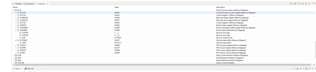

I started out with a simple example for the SCI echoback, Example_2806xSci_Echoback.c, and was able to modify the code and just output text over and over and view it through my logic analyzer. Now, I am trying to enable and use the tx and rx pins through the sci.c in instaspin lab10d. When I put in the code to do so, I did not see any data coming out with my logic analyzer. This lab also toggles the leds. So for a sanity check, I tried to see if I could just turn off one of the led's. So in the proj_lab10d.c, I commented out the code on line 463 and put this line of code and a couple of others on line 230-232 with no luck. The light remained on. So, I am stumped on how to accomplish what I'm trying to do. In the Example_2806xSci_Echoback, gpio29 referred to j1.4 pin. Does the GPIO_Number_29 in the gpio.h of the instaspin lab refer to that same j1.4 pin? Or maybe I did not enable something in my sci code. What am I doing wrong? And why won't a simple call to the toggle function turn off the light? However, when it is in the infinite for loop it toggles it on and off?
My code in proj_lab10d.c for the sci enabling is from line 218-261 and then I attempt to send data on line 439.
proj_lab10d.c

* TESTING GPIO FOR UART OF GPIO28 AND GPIO29
HAL_Obj *obj = (HAL_Obj *)halHandle;
// Set pullups
GPIO_setPullup(obj->gpioHandle, GPIO_Number_28, GPIO_Pullup_Enable);
GPIO_setPullup(obj->gpioHandle, GPIO_Number_29, GPIO_Pullup_Enable);
// Set gpio 28 as async input and as SCIRXDA
GPIO_setQualification(obj->gpioHandle, GPIO_Number_28, GPIO_Qual_ASync);
GPIO_setMode(obj->gpioHandle, GPIO_Number_28, GPIO_28_Mode_SCIRXDA);
// Set gpio 29 as SCITXDA
GPIO_setMode(obj->gpioHandle, GPIO_Number_29, GPIO_29_Mode_SCITXDA);
// GPIO_setLow(obj->gpioHandle, (GPIO_Number_e)HAL_Gpio_LED2)
// GPIO_toggle(obj->gpioHandle, (GPIO_Number_e)HAL_Gpio_LED2);
// HAL_toggleLed(halHandle,(GPIO_Number_e)HAL_Gpio_LED2);
// Enable fifo
SCI_enableRxFifo(obj->sciHandle);
SCI_enableTxFifo(obj->sciHandle);
* 1 stop bit, No loopback, No parity,8 char bits, async mode,
* idle-line protocol
SCI_setNumStopBits(obj->sciHandle, SCI_NumStopBits_One);
SCI_disableParity(obj->sciHandle);
SCI_setCharLength(obj->sciHandle, SCI_CharLength_8_Bits);
SCI_setMode(obj->sciHandle, SCI_Mode_IdleLine);
* enable TX, RX, internal SCICLK, Disable RX ERR, SLEEP, TXWAKE
SCI_enableTx(obj->sciHandle);
SCI_enableRx(obj->sciHandle);
SCI_disableRxErrorInt(obj->sciHandle);
SCI_disableSleep(obj->sciHandle);
SCI_disableTxWake(obj->sciHandle);
// Set baud
SCI_setBaudRate(obj->sciHandle, SCI_BaudRate_57_6_kBaud);
