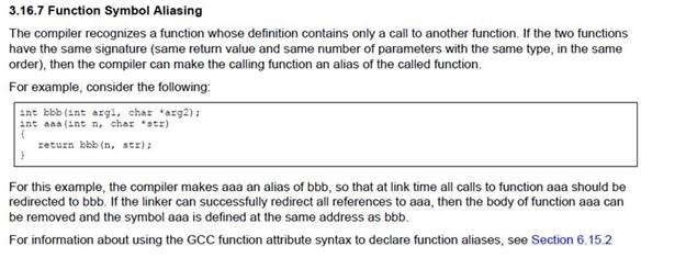

① The customer looked at C:\ti\ccs1100\ccs\eclipse\plugins\com.ti.ccstudio.usersguide.doc_11.0.0.202109231134\html\images\c28x_compiler_optimization.pdf, there is such a page in this document as shown below. Customer checked the assembly code of several loops and found that the assembly results of int variables and uint variables are the same regardless of whether optimization is turned on or not. I didn't find an explanation for this part either, could you please help to check why it prefer signed over unsigned?

    (1) After using optimizations, will it cause an error if the code have function aliasing? Is there anything that needs special attention?
    I'm not sure what you mean.  Please show an example.

    Thank you for your reply! Let me clarify customer's question. I don't know how to quote your answer, so I just repost the remaining two questions from the customer:
    ① In optimization O2 and below, when C program calls hand-coded in assembly or hand-coded in assembly calls the C program, is it necessary to check the assembly code after compilation?(According to your previous answer, my understanding is NO?)
    ②Customer want to know if they have optimizations enabled while function aliasing exists, will there be problems caused by optimizations?
    No.
