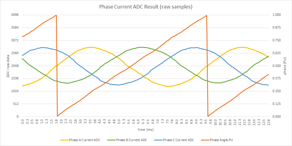

Here are some graphs. These show various variables from the controller just before control is lost. First one is phase voltage ADC result (this is the result of the ADC conversion, so 4095 is a full-scale reading... there is no saturation occurring).
Here is a second graph of the same event showing ADC results for the current sense ADCs as well as the FAST estimated flux angle (labeled "phase angle" in the graph). We are nowhere near saturating, but you can clearly see somewhere around sample number 186 things start to go bad. However, we are still nowhere near numerical saturation of the ADC (phase angle is in PU on right hand axis). NOTE: all of these graphs are time correlated. Sample 186 on this graph corresponds to sample 186 on the other two graphs. The only reason I am posting three separate graphs is because it is too hard to see what is going on if all traces are on the same graph.

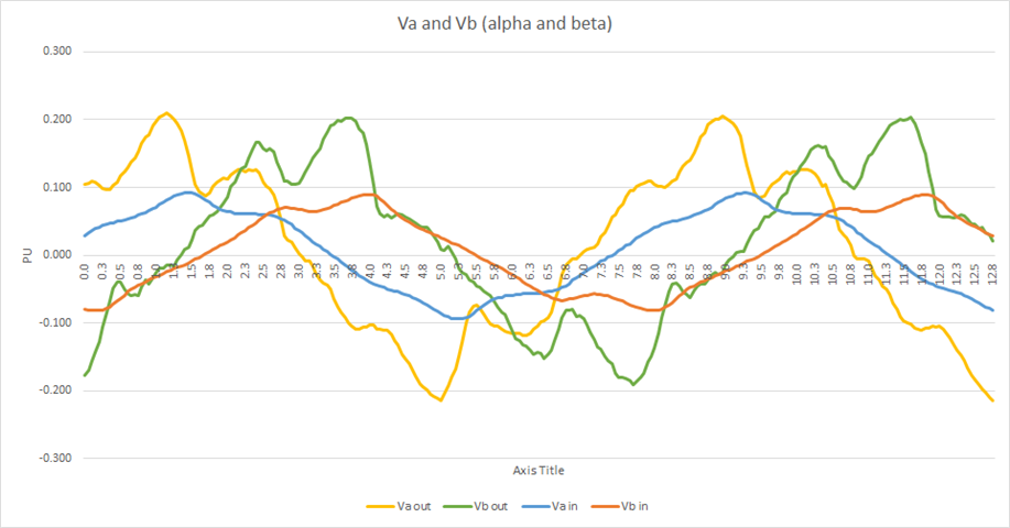

Finally, here is a graph of Vd and Vq. As you can see, somewhere around 186 Vd and Vs are numerically saturating high while Vq is saturating low shortly after. This is when control is lost.

How do you get these graphs? Can you monitor the d-axis reference current and feedback current to know why the d-axis voltage is so big variable?
Is it possible to use the oscilloscope to capture some phase voltage waveforms on the ADC input channels? And capture the current waveforms with the current probe. Seems like the current and voltage shapes have distortion on the graph above.
We created circular buffers to monitor variables of interest. The circular buffer is updated every sample (20 kHz). Then we put in code that checks the current every sample. If the current is > max instantaneous current, we set the controller to offline state and stop logging to the circular buffers. After the over-current event, we manually cut and paste the data from the debugger window in code composer into a spreadsheet.
The D-axis reference current is fixed (we are in torque control mode) but we can try capturing the Q and D axis feedback current. We have a lot of things to work on, so it may not happen immediately, but we will do it at some point.
While it is possible to capture data on the oscilloscope, it is difficult to synchronize the oscilloscope data with the internal data. Also it is difficult just because the components and pins and pads are small. But we can capture some example waveforms during good operation (before tripping).
Got it. I just doubt that the phase voltage waveforms are not smooth with distortion. What dc bus voltage is implementing on the inverter? And what's the value of USER_ADC_FULL_SCALE_VOLTAGE_V and USER_VOLTAGE_FILTER_POLE_Hz of the hardware board?
We have changed our filter pole based on previous feedback. Below is the up-to-date value.

OK, I have some more data graphs to show. We are operating at low speed (about 770 RPM) in regen with Iqref set at -50 Amps. It appears to me that Vd is really messed up with very large ripple at 6x the electrical frequency. This seems to be the root cause of why the voltage waveform is so distorted. VBAT was at about 52 V. The VBAT ADC is not anywhere near numerical saturation. See last graph.
Do you have any idea why Vd has so much ripple? I believe this is the root cause of why the output voltage is so distorted. Should we try tuning the PIDs, or adding a digital notch filter to remove the ripple from Vd (and possibly Vq also?) What do you suggest? Do you think this issue could be related to the speed divergence (see my other question on this forum).

Your previous posts suggest there was issue in your ADC voltage divider design. There was no response posted as to having corrected dividers resistance values adding 30% ADC overhead. It is obvious you do not have full understanding of DRV8353 two braking modes mentioned, neither did I. Off handedly I suggested an alternative DRV8353 configuration can use INLC pin 39 with x69M PWM output interrupt to modulate low NFETS much like my system described above. That was more of a gee-whiz how nice those two features are for other future post readers.
Maybe the Id feedback value is significantly variable. Could you please check the Id reference and feedback values when run the motor in this mode and state?
Yes, you can try to use different Kp&Ki of the Id PI controller. To reduce the Ki first. Seems like the phase voltage waveform you captured by the oscilloscope has distortion, it's not right as the machine runs in motoring mode.
Current waveform looks good, but the voltage waveform is not right as mentioned above. No more ideas about this, have to find the root cause on the voltage sampling signals. I have tried to repeat the issue, but it's not easy to do it till now in our lab.
Can you help to check if the "gMotorVars.Flux_VpHz' has very big variable in generating mode vs. motoring mode?
I will try looking at the Id feedback values. Id reference is fixed at 0.
I will check out gMotorVars.Flux_VpHz.
The voltage waveform is the actual voltage waveform. The controller is putting out that voltage waveform. The voltage sampling process is not adding distortion to the voltage. Since the controller is putting out the distorted voltage waveform I am asking for your help to figure out why. Vd has a very distinct ripple at 6 x the electrical frequency. Do you have any idea what might be causing that? Have you ever seen it before? That 6 x ripple is visible in the voltage output, the current output and even the battery voltage has ripple at 6x the electric frequency.

The ADC current wave forms (75 amps peak?) are well below MSB according to the debug plots just posted. I'd expect current peaks to be closer to 3585 counts or a bit below, again precision affects Clare transforms. BTW the scope capture (CH2) 100A P2P or 50A peak, that is well above 75A previously stated.

On the one hand you seem to suggest that I am not making good use of the full range of ADC inputs for voltage. On the other hand, you seem to be indicating that I need to add headroom. Do you not understand that those two things are absolutely directly contradictory? If I adjust the voltage divider by making the 11.3k resistor smaller, I will utilize even less of the ADC range. Please let me know if I need to go through it step-by-step with all the calculations. I am aware that TI design documents recommend having 30 percent extra headroom above the highest expected voltage. Perhaps, later, when we are using fully charged batteries, I will change the voltage divider ratio. But for now, with a battery at 52 V, there is no need to alter the resistor divider for VBAT or the phase voltages.

You and I have discussed the current ADC already. It is not possible to utilize the full ADC range because the current shunt amplifiers do not have a linear response over the full rail-to-rail output range. In the most recent capture the shunt resistors are 300 uOhm and gain is 40 V/V. I do not have infinite freedom to choose any shunt value and any gain I want. I think this combination of 300 uOhm and 40 V/V will be OK.

The voltage waveform is distorted BECAUSE THE INVERTER IS OUTPUTING A DISTORTED WAVEFORM. You can see this very clearly when you look at the Vd and Vq outputs from the PID or Valpha and Vbeta (after the inverse park transform). Valpha and Vbeta are used by the output stage of the controller to calculate the duty cycles that set Va, Vb, and Vc. So if Valpha and beta are distorted, the output voltage will also be distorted. It may help to look at the block diagram of how sensorless FOC works.
Right I'm saying the voltage peaks are nowhere close to MSB if that is 30% OVH. Seems much greater than PDF loosely worded text, closer to MSB. Seemingly with the correct divider values the signal will peak closer to MSB 4096 -30% is 2867 counts. The 215k seems high for 50v, I used 182k/3K9 for Nominal +100V and FSV +163.59V. You're right the current amplitude is ok does not use R dividers but does enter Clarke. Settling time for inductive current depends on the amplifier BW and CMRR, INA240-A1 claims 9.6µs settling to 5% of the output signal. The ADC window time for both might require tweaking and 3-5 PWM periods trigger delay up to SOC.
Agree but why are the Clarke EMF inputs distorted the bigger question, seems power supply related seeing VBat signal. Curious if you leave Lab 4 default torque settings do the EMF signals improve with positive torque values?
