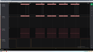

  • Ajay,
    Logic analyzer you are using seems to support only upto 8 MHz. In your SPI code, you are using SPI at 40 MHz. Your logic analyzer will not be able to sample SPI signals fast enough.
    Switch oscilloscope with much higher bandwidth.
    Manoj
  • Manoj,
    Unfortunately we don't have the support of oscilloscope, so we reduced the clock frequency to 1MHz. still the problem hasn't resolved yet.
    below are the screenshots for clk frequency 1MHz.

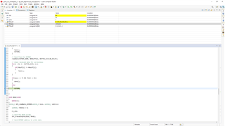

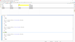

    Below : Expression window while transmitting and receving  YOU CAN SEE THAT THE SEND DATA AND READ DATA ARE MISS MATCHED.
    sendData = transmit data.
    readData = Receive data.

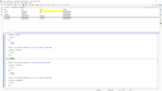

    Below are the screenshots of TX and RX buffers while transmitting and receiving data.
    TX buffer
    RX buffer

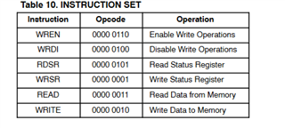

  • Are you writing and reading from the same EEPROM address? The logic analyzer snapshots don't seem to suggest so.
    When you attached scopeshots please let us what you are transmitting and receiving. Provide clear description of the problem going into the details. It is difficult to decipher looking into scopeshots and arbitrary code for us to find the problem.
    For example:
    1) Transmit WRITE ENABLE byte (0x06)
    2) Transmit byte 0x02 (What does this byte represent? Is this WRITE command byte?)
    3) Transmit 0x0 (Is this EEPROM address?) Why are you sending two 0's
    Did you read any status register in EEPROM to make you a reading from EEPROM correctly?
    Also, have you check spi_ex6_eeprom example in C2000Ware?
    Manoj
  • Manoj,
    Yes we are reading and writing in the same address (0x0000).
    Yes, 0x02 is a Command to write data to the address. and in the Read screenshot byte 0x03 is read command to read an address.
    The EEPROM has a 16 bit address array and we are sending data in 8bits, hence the two 0's.

  • SPI EEPROM provided was written with EEPROM AT25128/256. The command structure might not be the same across different EEPROM vendors. You mostly likely have to adapt this example for your EEPROM.
    CAT25128 datasheet want user to send only 1 byte address after OPCODE. why are you sending two address bytes?
    Manoj
    The command opcodes are same for AT25128 and CAT25128. And we have adapted the example to for our EEPROM.
    The CAT25128 uses 16-bit address array so i send 2 bytes of address data.
