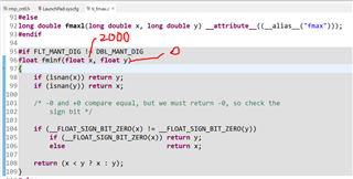

Debugging, I can see that RampDelayCount increases at every fclRampControl call. SetpointValue increases whenever the time comes, as shown in the following picture:
But right after this increase, if I click "Step Over" to control the execution of the code, it stops at the line shown in the following picture:
If I understood it properly, the compiler decided that that zone was to be left out, as indicated by the shaded lines, but it was not left out and not even that but also it is being run. If I step into, I get into the piece of code showed in the following picture:
Where this function compares 2000 and what should be 0.00001525f, but for some reason it indicates 0 while debugging, maybe due to casting.
My question is, why is the RampCtrl behaving like this? Id there any initial configuration I missed? Why is the MCU running code which the compiler shades?
