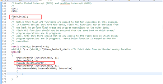

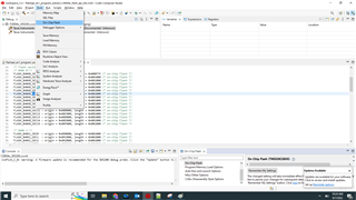

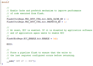

Based on the project example "flashapi_ex1_program_autoecc", I add an reading a word from Sector6_start, and run the code on demo board Launchxl-F280049c, I found that, the MCU will reset with 20ms period. So, I need your help, tks!
see the details as bellow:
1.Based on example code, move the initialization part of Example_CallfFlashAPI () to flash_ init(), keeping the rest of the code(erase and program) in Example_CallfFlashAPI ().
2.Flash_ Init() is placed after ERIM, and Example_CallfFlashAPI () is placed in while (1);
3.Read a word from  Sector6_start before calling Example_CallfFlashAPI (): uint16_t *p = (uint16_t *)Bzero_Sector6_start; data_tmp[0] = *p;
4. Use GPIO35 as debug output;
Please refer to the following code:

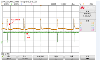

5.Download to demo board, pressXRSn repeatedly. After several times, MCU will reset actively at 20ms interval. It can only be recovered by flashing code with JTAG. The measured waveforms are as follows:
6.Use the GPIO35, I can confirm that, the MCU ran away when calling read flash:data_tmp[0] = *p;
Is there any improper operation?
Look forward to your reply, tks

  • Hi Vamsi,

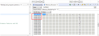

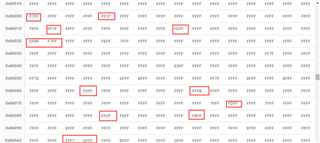

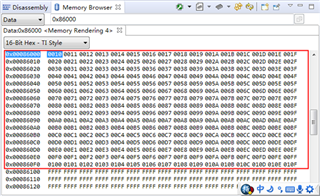

    The watchdog is disabled. The code can run normally unless pressing the XRSn frequently to simulate the power down and on. Once the abnormality occurs, the content in sector6 have been damaged:
    the sector6 data after abnormality:
    the sector6 data before abnormality:

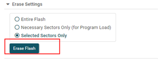

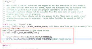

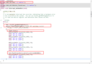

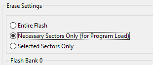

     I have found that, there are two ways to recovery: download the code via CCS or only erase sector6 via uniflash.
    I guess that, by pressing XRSn frequently, the board may be powered down when erase or program flash is executing, and then will cause damage to the sector6.
    I also tried to erase the sector6 by code in NMI handler, but it can not erase it successfully. please help analysis, thanks.

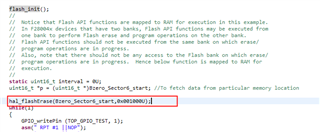

        static uint16_t interval = 0U;
        uint16_t *p = (uint16_t *)Bzero_Sector6_start; //To fetch data from particular memory location
        while(1)
            data_tmp[0] = *p;
            Example_CallFlashAPI();

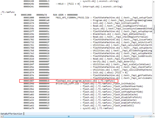

    //  Example_CallFlashAPI
    //  This function will interface to the flash API.
    //  Flash API functions used in this function are executed from RAM in this
    //  example.
    #ifdef __cplusplus
    #pragma CODE_SECTION(".TI.ramfunc");
    #else
    #pragma CODE_SECTION(Example_CallFlashAPI, ".TI.ramfunc");
    #endif
    void Example_CallFlashAPI(void)

    Why are you doing frequent resets during erase or program operations?  Reset during erase or program operation can corrupt the flash contents.
    Regarding recovery: If Uniflash is able to recover, CCS also can recover it.  You can select erasing sector 6 in CCS flash plugin GUI.
    Do you want me to review your code to know why your code is not able to erase the device after the frequent resets?
    Thanks and regards,
    Vamsi
  • Hi Vamsi,
    In our products, we need use one sector to store several data, therefore, we should read all content from this sector before erase-program sequence, and then program these new data into this sector again. But it is abnormal at customer side, and we found the above issue. Then we tried to test the same FLASH function on demo example, it aslo occurred.
    My question is, whether these are wrong with my code?  If power down during erase or program operation can corrupt the flash contents, are there any recovery methods without erased by external tool? In practical application, we can't determine the power down time, so the abnormality is inevitable, and we should take a recovery mechanism, how should we do?
    thanks.
    I will review and get back to you in a day or two.
    Thanks and regards,
    Vamsi

    Are you using RAM config or flash config linker command file?
    Are you executing ROM flash API?  Or is the flash API mapped to a sector and copied to RAM?  If mapped to a sector, which bank/sector is it?
    Thanks and regards,
    Vamsi
  • Hi Vamsi,
    I use flash config linker cmd as below, Flash API is mapped into FLASH_BANK0_SEC1, and copied to RAM for running.

  • Hi Vamsi,
    I observed that the XRSn pin will actively output low level with 20ms interval, you can refer to the following waveform captured in abnorma case, thanks.
    Maybe a NMI reset due to flash ECC error.
    Does your application read the sector 6 that has invalid data/ECC?
    Thanks and regards,
    Vamsi
  • Hi Vamsi,
    Yes, as you said, I inserted some debug code into source code and found that, after the abnormality occurred, the MCU entered into Interrupt_nmiHandler(void) when executing read one word from Bzero_Sector6_start. The SYSCTL_NMI_FLUNCERR flag can be read as 1 in NMI interrupt. I tried to erase the Sector6 in NMI interrupt, but the error can not disappear. Please refer to the following NMI code which I wrote in the file interrupt.c:
    static void Interrupt_nmiHandler(void)
        uint16_t tmp = 0;
        // A non-maskable interrupt has occurred, indicating that a hardware error
        // has occurred in the system.  You can use SysCtl_getNMIFlagStatus() to
        // to read the NMIFLG register and determine what caused the NMI.
    //    ESTOP0;
        for(;;)
            tmp = SysCtl_getNMIFlagStatus();
            SysCtl_clearAllNMIFlags();//reset NMI watchdog counter
            if(tmp == SYSCTL_NMI_FLUNCERR)
                GPIO_writePin (TOP_GPIO_TEST, 0);
                asm(" RPT #1 ||NOP");

                hal_flashErase(0x09E000,0x001000U);//try to erase corrupt sector
    I also found that, if use the uniflash to erase sector6 only, the error can disappear and MCU ran as expected. I didn't know erase operation difference between uniflash and call erase API.
    Is there any method to resolve this error by code?

    Maybe the NMI watchdog is causing a reset and halting the erase.

    Correct previous code in Interrupt_nmiHandler(): hal_flashErase(Bzero_Sector6_start,0x001000U)
        uint16_t tmp = 0;
    //    ESTOP0;
        for(;;)
                GPIO_writePin (TOP_GPIO_TEST, 1);
                hal_flashErase(Bzero_Sector6_start,0x001000U);//erase corrupt sector6

    I have added #pragma CODE_SECTION(".TI.ramfunc") before flash_init() and hal_flashErase(), and the map file is below, thanks.
    Could you send me your map file?  If you don't want to share it here, you can share on private chat.  Please remove the proprietary info (if any) from it.
    Thanks and regards,
    Vamsi
  • Hi Vamsi,
    I upload the project for your reference.
    flashapi_ex1_program_autoecc.rar

    On the erase failing device, if not in the NMI ISR, can you try to load the C2000Ware flash programming example as-is and see if that can erase the sector successfully?
    You can edit for the erase of the required sector.
    Thanks and regards,
    Vamsi
  • Hi Vamsi,
    On the erase failing device, once re-loaded the code by CCS or uniFlash, the whole sector can be erased successfully and running normally. We also try to only erase the sector6 by uniFlash, and after powered on, the device can also run normally. it indicates that, the corrupt sector6 can be erased by uniFlash, but can not be erased by source code?
    Maybe my suggestion was not clear.  Please let me clarify:  Once the failure happens, instead of using CCS or Uniflash to erase, do a debugger reset and load the flash programming example and erase the sector 6 using that example.  Let me know how that goes.
    Thanks and regards,
    Vamsi
  • Hi Vamsi,
    Sorry, I didn't understand, how to load the RAM without connected CCS or uniFlash? Could you give operation guideline? thanks.
    Could you explain the difference between two erase operation: execute erase in uniflash and execute erase by calling F021 API.
    There is no any difference in the erase process between the flash API and the CCS/Uniflash tool.
    Reason I asked you to run the C2000Ware flash API programming example is:  If that succeeds, that tells me that something in your application is not configured correctly for the flash erase.
    Regarding the flash programming example:  When the flash sector 6 erase does not succeed with your application, please import the C:\ti\c2000\C2000Ware_x_xx_xx_xx\driverlib\f28004x\examples\flash\flashapi_ex1_program_autoecc.c project, compile it and then and load the executable to the device flash.  Before loading, please modify the flash plugin GUI's erase settings as shown below so that sector 6 does not get erased by the CCS flash plugin.  After loading, execute the example and see whether erase of sector 6 succeeds or not.  If it does not succeed, we can have a debug call/meeting to analyze further.
    If you don't know how to navigate to the flash plugin GUI in CCS debug view, please see below:
    Please note:  Previously I suggested RAM load to ensure that flash won't get erased during load.  However, I felt it might take more time for you to create a RAM based example and hence suggested to configure the Erase Settings as shown above.
    Thanks and regards,
    Vamsi

    3.I tried to move the erase function to NMI handler as below, but the abnormality still exists, it means the sector 6 can not be erased in NMI handler.
    Now, I found a valid method to resolve this issue: In NMI handler, just execute empty loop: "for (;;)" , then it will trigger the NMI watchdog reset, and then NMIWDRSN reset source can be obtained. The code is as below, and MCU can be recovered from the abnormality.
    But, my question is, why the sector 6 can not be erased successfully in NMI handler? Do you know the reason?

  • Hi Vamsi,
    Sorry for the late response. Please see the following content:
    best reqards,
    Please send the snap of the DCSM USER OTP space (not the register space).
    Thanks and regards,
    Vamsi
  • Hi Vamsi,
    Could you give an guideline, how to get the DCSM USER OTP? thanks
    In the debugger CCS window, you can enter the address that you want to view.  In the datasheet's memory map section, you can get the address range of the DCSM OTP.
    Thanks and regards,
    Vamsi
  • Hi Vamsi,
    Please refer to the following user OTP content, if any concern, inform me, thanks.
    I will ask our security expert to take a look at the OTP configuration.
    Thanks and regards,
    Vamsi
    Our security expert is not available this week.  He will be able to take a look at this next week.
    Thanks and regards,
    Vamsi
    Our security expert Pramod reviewed the DCSM OTP configuration today and confirmed that every thing is at default.
