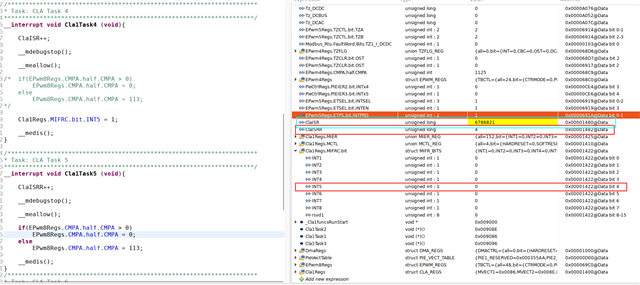

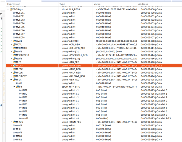

  • Hi Ashwini,
    I used PWM8 to change CMPA from 0 to PRD and PRD to 0 diring task to have a simple debug . It seems to work.
    But....
    New problem.. As explained previously I have two tasks: TASK 4 and TASK 5 corresponding to an interruption at the period of PWM4 and PWM5. For PWM4 no problem I see task4 count variable moving but nothing for PWM5. It doesn't work while I have the same configuration.
    When I forc TASK using Cla1Regs.MIFRC.bit. INT4 or INT5 or INT8 it work correctly and I can saw variables in tasks changing but there is only INT4 working auto and autonomously.
    Please help me I spent already many many time to debug it. It's too too long
    regards,
    Ol

    // Enable the IACK instruction to start a task
    // Enable the CLA interrupt 8 and interrupt 7
    Cla1Regs.MCTL.bit.IACKE = 1;
    Cla1Regs.MICLROVF.all = 0xFFFF;
    // Copy the CLA program code from its load address to the CLA program
    // memory. Once done, assign the program memory to the CLA
    // Make sure there are at least two SYSCLKOUT cycles between assigning
    // the memory to the CLA and when an interrupt comes in
    memcpy(&Cla1funcsRunStart, &Cla1funcsLoadStart, (Uint32)&Cla1funcsLoadSize);
    Cla1Regs.MMEMCFG.bit.PROGE = 1;
    // Cla1Regs.MMEMCFG.bit.RAM0E = 1;
    Cla1Regs.MIER.all = (M_INT4 | M_INT5 | M_INT8);
    //Cla1Regs.MIER.bit.INT4 = 1; // Enable Task1
    //Cla1Regs.MIER.bit.INT5 = 1; // Enable Task2
    //Cla1Task8();
    Cla1Regs.MIFRC.bit.INT8 = 1;
    asm("EDIS");
    } // end of InitCla()

    __interrupt void Cla1Task4 (void)
    ClaISR++; // = ClaISR + 1;
    __meallow();
    Cla1Regs.MICLR.bit.INT4 = 1;
    //ClaISRR++;
    //__mdebugstop();
    if(EPwm8Regs.CMPA.half.CMPA > 0)
    EPwm8Regs.CMPA.half.CMPA = 0;
    else
    EPwm8Regs.CMPA.half.CMPA = 113;
    __medis();

  • but nothing for PWM5.
    I don't see anything in the CLA configuration that may be causing this. Can you set a breakpoint after InitCla is complete and take a look at CLA configuration registers in CCS registers window to check that the register configuration looks correct. Also can you setup the EPWM5 to trigger the C28 CPU - this will ensure that EPWM5 configuration is correct and is indeed generating a trigger.
    Cla1Regs.MICLR.bit.INT5 = 1;
    Why is the task doing this, the INT5 is cleared automatically when task is entered. Also this register is accessible by C28 CPU only and CLA task cannot write to it.
    Ashwini
  • Hi Ashwini,
    Thank you for your answer.
    It seems to be ok.

  • ClaISR variable is declared as CLAtoCPU used in TASK4 (PWM4INT) and it is running automatically every PWM4 period. ClaISR is incremented. I saw it in CCS watch window.
    ClaISRR variable is also declared as CLAtoCPU and used in TASK5 (PWM5INT) but it is not running.
    If i use Force INT5, ClaISRR variable is properly incremented but the task5 is not trigger as interrupt.
    If I make de test with this line in TASK4 to start INT5 Cla1Regs.MIFRC.bit.INT5 = 1;
    It doesn't start too.
    TASK5 is executed ONLY if I FORCE interrupt in CCS Wtach windows.
    Whey TASK5 is not triggered by PWM5INT ??

    What I observed is that I have to activate the IT of the CPU so that it is effective in the CLA.
    The reason why PWM5 was not working in the CLA, was that it was not enabled in the CPU while PWM4 was enabled in the CPU and running as can be seen from the code snippet provided. I also tried with the other PWMs (1 and 2) and it reacts (responds) exactly by the same way. The Interrupt must be enabled and running in the CPU for it to be used in the CLA.... I do not understand why.
    That is correct, they are independent. The interrupt can be setup to trigger either the C28 or CLA and does not have to do both.
    Clearly not in my code. PWM4A is the main IT of my prog at the period. I have both enabled (PWM4 INT) in CPU and also in the CLA at the same time and it works.
    Why do I have to activate the CPU IT to make the CLA IT work ?
    Olivier
