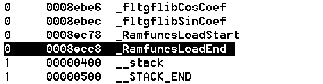

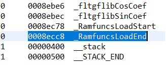

    I use bin.file for programing file to TMS320F28739D by maens of own bootloader. But I have problem with lenght of program. When I check programmed data in flash memory by means of Adler CheckSum, the checkSum in uncorrect.
    I would like to ask you. I checked my file.map and I find one things which I don't understand.
    Is it corect when in file.map I see that FLASH memory is used in range 0x840822 up to 0x8ECBE (0x840822 + 0xac3c), see picture 1 but the ending address of global symbols in flash memory according file.map is on address 0x8ecc8, see picture 3. Becase endding adrress is not included in range 0x840822 up to 0x8ECBE of used FLASH memory.
    Pic. 1
    Pic. 2   The begining addrress of program
    Pic. 3  The ending addrress of program
    Whole file.map is here below.

    0     0008ecc8  _RamfuncsLoadEnd
    abs   00000050  _RamfuncsLoadSize
    0     0008ec78  _RamfuncsLoadStart

    0     0008dfa7  __register_lock
    0     0008dfab  __nop
    0     0008dfac  _SetDBGIER
    0     0008dfaf  __system_pre_init
    0     0008dfb1  ___etext__
    0     0008dfb1  etext
    0     0008dfb4  ___cinit__
    0     0008dfb4  cinit
    0     0008e9cc  _PieVectTableInit
    0     0008eb8c  _CLBptrs
    0     0008ebca  _f32gflibCosCoef
    0     0008ebd4  _f32gflibSinCoef
    0     0008ebe6  _fltgflibCosCoef
    0     0008ebec  _fltgflibSinCoef
