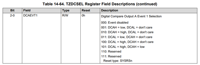

How do I configure CMPSS3 (TRIP4) to trigger CBC trip for ePWM2A and CMPSS4 (TRIP5) to trigger CBC trip for ePWM2B?
If it is not possible independently, how can I make TRIP3 or TRIP4 both trigger the CBC trip at the same time for the ePWM2A and ePWM2B outputs?
I assume DCA(H/L) is used for PWMA and DCB(H/L) is used for PWMB. correct? Why are there H and L possibilities?
